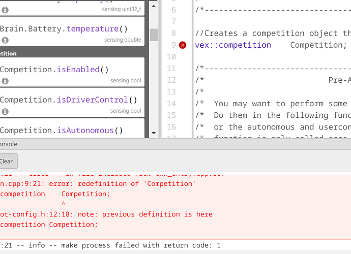

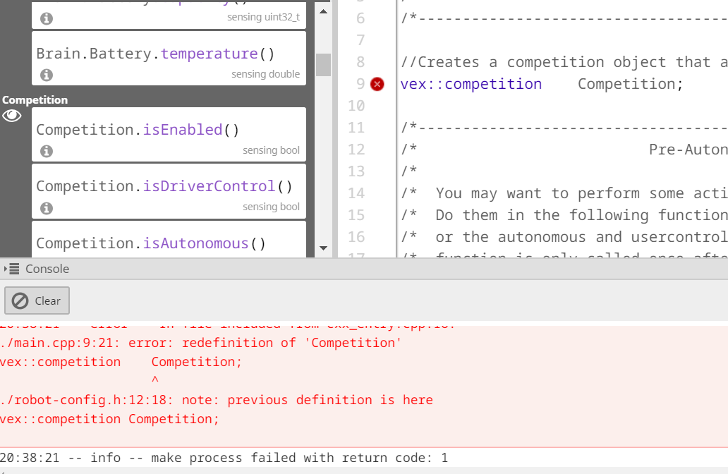

I am new to VCS, and I opened a competition template, and it’s giving me this error (image attached). How do I fix this?
either uncheck the competition checkbox or delete the instance of vex::competition in the code, it’s a bug in VCS 1.0.
