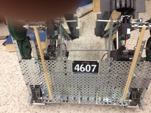

Here is my set up from the back. I have 5 rubber bands on each side… Now this lifts my front off the ground which isn’t good…But it still isn’t holding like I would like during autonomous… I think I can move my anchors up a little to keep it from lifting the front of my intake from the ground. The question is, how do you find that “sweet” spot… That keeps the front intake where it should be, but put enough tension to keep it from falling during autonomous…
Well first of all I suggest using a small standoff instead of an axle because that will give stronger support and will be easier to put on/take off rubber bands. Second I suggest using at least 8-11 rubber bands on each side. Try experimenting until you find that sweet spot.
Well we had 10 on each side but it’s lifting the front intake off ground. We were doing standoff but it was a pain when adding more to unscrew stand off. We use shaft and collars and we can just loosen one side slide over and add more bands quicker.
why do you need to unscrew the standoff? you can just lift the arm all the way and put on and take off rubber bands. If 10 is too much then try 8.
Maybe I am confused… I had the stand off screwed on both sides so I would have to unscrew then slide bands on. Are you saying just screw the standoff on one side and leave a gap on the other so you can just slide them on and off?
We found that angling our tension helped a lot with the problem of having to balance “the amount of tension to lift the arm” and “the amount of tension to keep the arm on the ground”. To do this, we bisected the angle formed by the arm (a six bar) and the vertical. Our reasoning behind this tension was
  1. When tension is parallel to the arm, it effectively does nothing at the lowest point (does not raise the arm off the ground). This tension is most effective at 90 degrees + the number of degrees you offset the tension from the vertical.
  2. When the tension is perfectly perpendicular to the ground, it is most effective when the arm is at raised 90 degree, but it will act upon the arm at its lowest position.
Thus, we found the midpoint to be the most helpful. Someone correct me if I’m extremely wrong – this is purely based on our own experimentation. Also, we use a PI loop just to iron things out, prevent motors from breaking or stressing out and go to certain setpoints.
