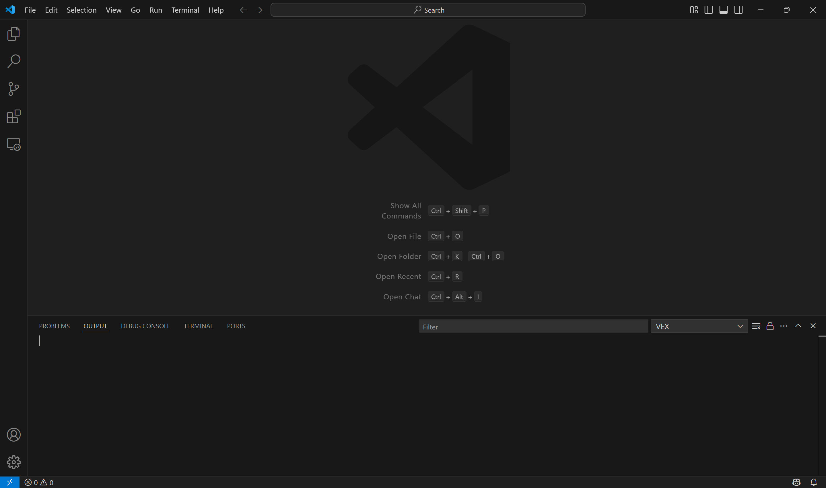

I just updated the VEX Extension, was the fix included in the update? I checked the settings for the extension and found “Vexrobotics › Vexcode.General: Enable User Terminal” , I think that might be new? I’m honestly not sure but I did try opening VCS while having the setting enabled, and disabled and both had the same result. This is the what my VCS looks like when I open it with the terminal (panel??) open at the bottom half of the screen:

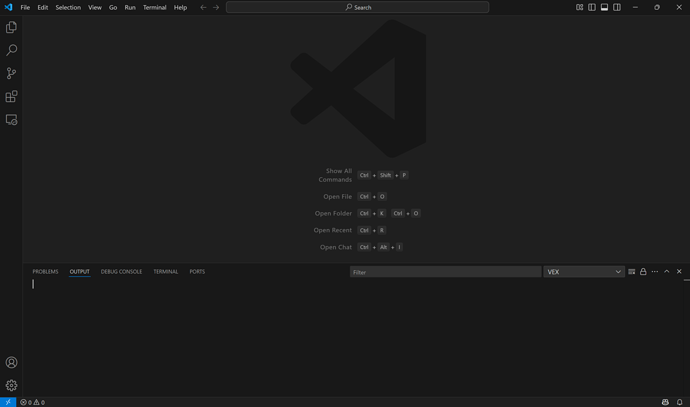

I think I figured out what this is supposed to be for, I switched the setting “Vexrobotics › Vexcode.General: Log Level” to Info (1) instead of Warning (3) and it spits out a bunch of stuff:
My original question might have not been clear cause I didn’t really know what it was the kept popping up. So to clarify, what I’m trying to ask is how do I disable this output log entirely? I had the output level on Error (3) and so nothing actually shows up in the Output as seen in the first screenshot, but for some reason it still “detects output” in that channel and automatically opens and switches to that channel when it spits it out when opening VCS or when something reloads or whatever.
