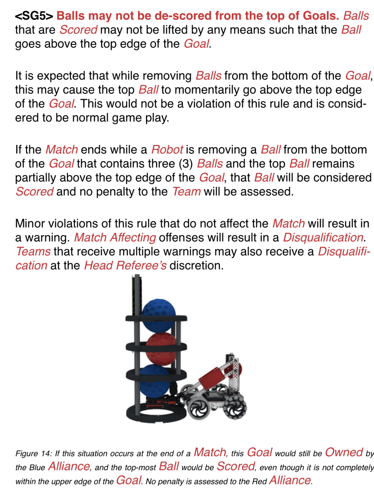

The rule specifically says that balls which are scored cannot be lifted over the edge, nothing about balls which aren’t scored. presumably that means it is legal.

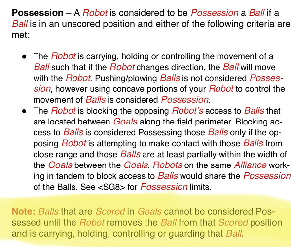

They may say you are possessing those blue balls.
Another interpretation of this makes me curious. At the bottom of the image in @MixieQueue ‘s post, it clarifies an interesting rule. It specifically states, in a situation like this, (the picture shows a claw bot claw doing the exact same thing as the OP’s idea; essentially the same situation) no penalty is assessed to the red alliance. So it’s still legal, BUT, in a case like this, it also says that the blue alliance would own the goal. Hear me out, that rule is clarifying this as if the red robot was trying to descore the bottom blue ball at the very end of the match, and clearly the tether wheel isn’t actively trying to descore anything. this is why it is a very questionable rule in this situation.
Also, for @9MotorGang ‘s comment, if this rule I stated applies, then you cannot be possessing either ball since they are both scored.
Edit: this is still a good idea; you just won’t be able to hoard the very top blue ball without it owning the goal.
So I think the Note would imply that red is possessing the top blue ball because the other 2 are scored. Theoretically, a robot could still clog 3 goals if 1 is considered in possession.
If you don’t put a blue ball on top, and just have 2 balls in the goal, then you could theoretically clog all the goals.
Edit: I just realized, if the blue ball was on top, would it even be counted as possessed by the red alliance?
