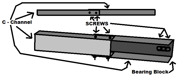

Sometimes, the c-channel is facing out when you want it facing in. One way to get by that is to attach two c-channels together facing apart from each other. (Picture attached; feel free to duplicate it. :p)
This allows the lift connection point to be closer to the manipulator/basket connection point, giving a more secure connection. If there are bearing blocks on the insides of the c-channels then a screw can be put through.
