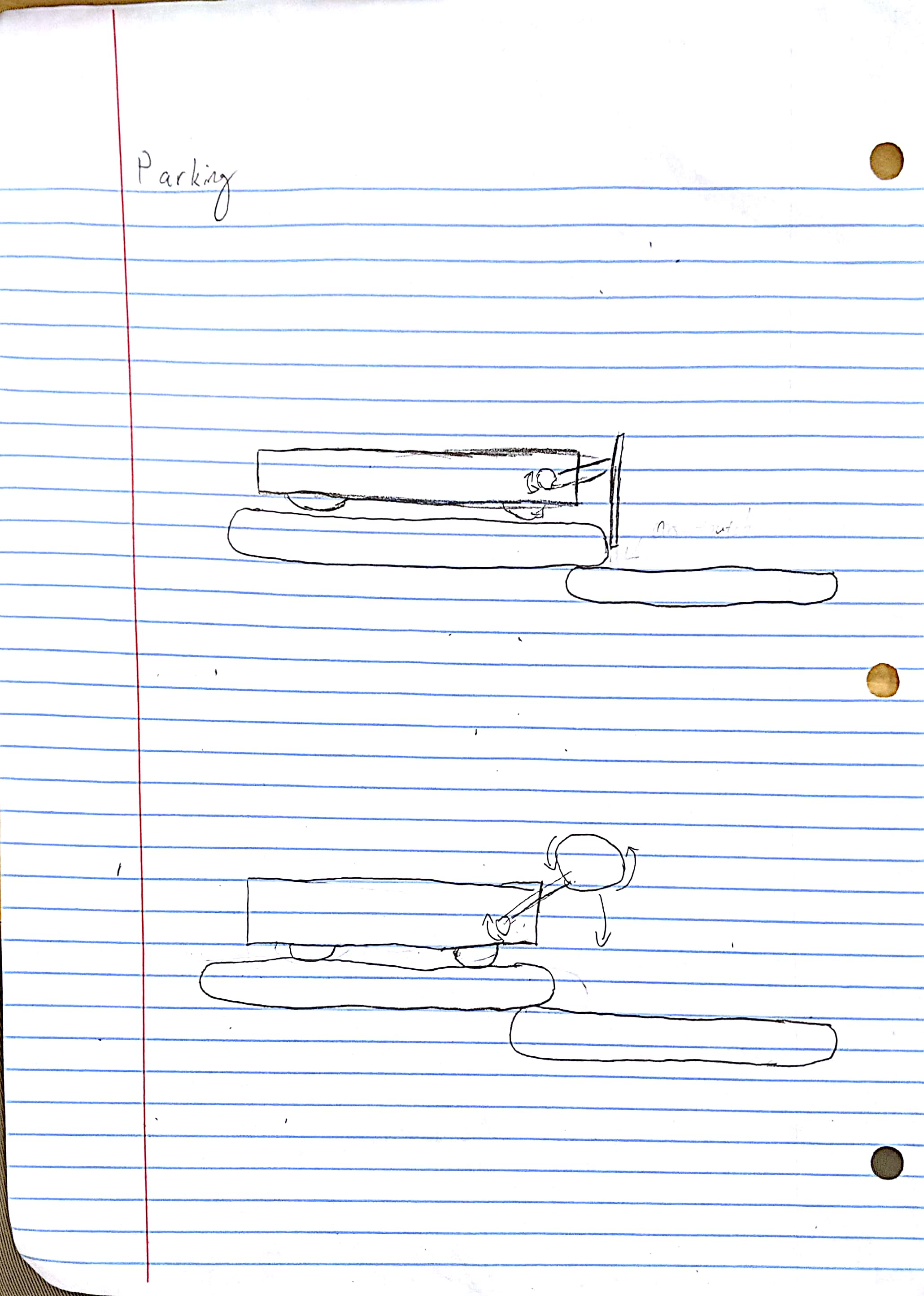

Here are my two ideas for parking.
The first one lowers a plate at the edge of the platform. While the other team is pushing it, they are forceing the plate in to the platform preventing them from climing it.
The second one is a wheel that lowers it self on to the other teams’ robot and push agienst them. (Dont know if legal or not)
that first one hmm, if it’s not grappling i dont see how someone can stop it, especially if you stick antislip mat on the inside of it so that its also difficult to push you from the side

@Beepbloop35211 Could the second idea be done using the roller intake used for intaking balls?
I don’t think that is legal since rule <SG10>: “Strategies with mechanisms that react
against multiple sides of a Field Element in an effort to latch or clamp onto said Field Element are
prohibited.” But the intention of this is to prevent damage to the field. So you might be able to get away with it by making it very loose.
That is a great Idea, but one problem that this design might encounter could be that the rubberband got caught on the other team’s robot and broke after every game.
I love people being innovative, but I don’t see any way that this mechanism would give any noticeable effect to the opponent. There is just no way this would gain traction on the opponent, and it wouldn’t generate much force even if it did. In my opinion it would be much better to invest motors in a wedge, brake, or more for the drive.
what about a base that extends off of the platform, this means that the c channel will be on the platform. Because of this the wheels will not be on the platform so you can still use omni wheels and not have to worry about being pushed off. I am not sure if this is legal though.
@MAX_901M I think the whole robot must be touching the centre platform?
Here. It can’t be contacting the Alliance Platform…
This is another example of a brake
