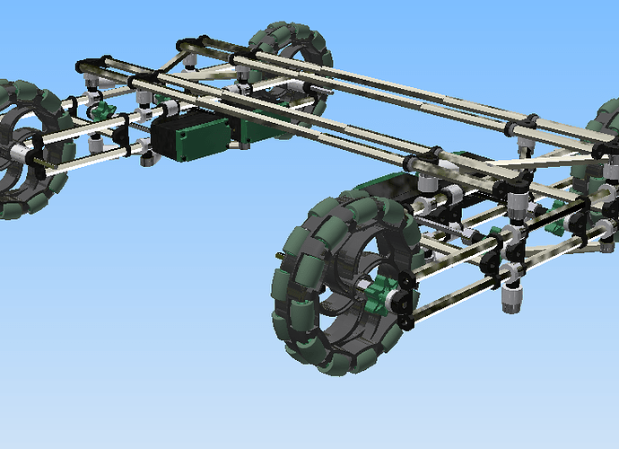

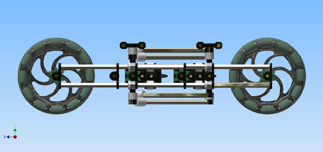

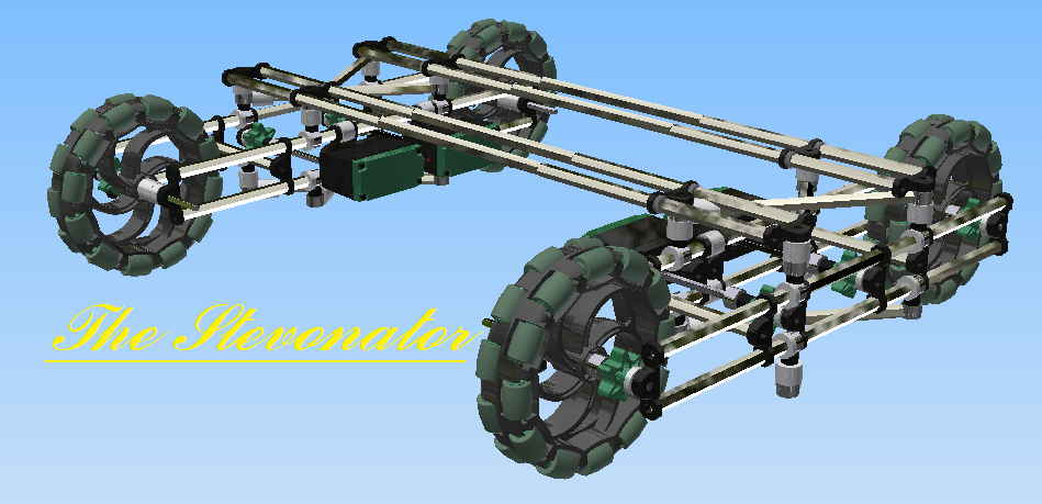

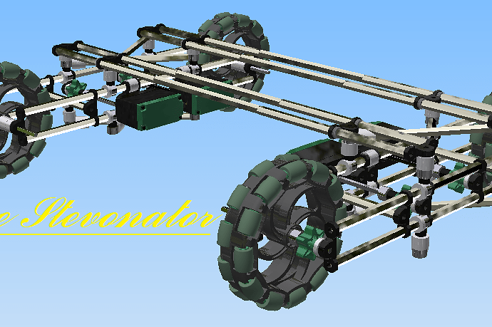

i got bored and this thing is what came out of my imagination. the name is inspired by Steven from 7700R’s standoff obsession
if you actually make this IRL please: 1. post a picture here and 2. experiment with how ridiculously fast you can gear the drive
Disclaimer:
This chassis is designed to be ultra-light to maximize potential speed output, minimizing and forgoing structural support to do so. If you attempt to use this for competition purposes, I am not responsible for whatever mess of broken parts remains after [unfortunate accident here] occurs. Thank you for understanding.
(Edit: Added more pictures)

Standoff is not known to be light.

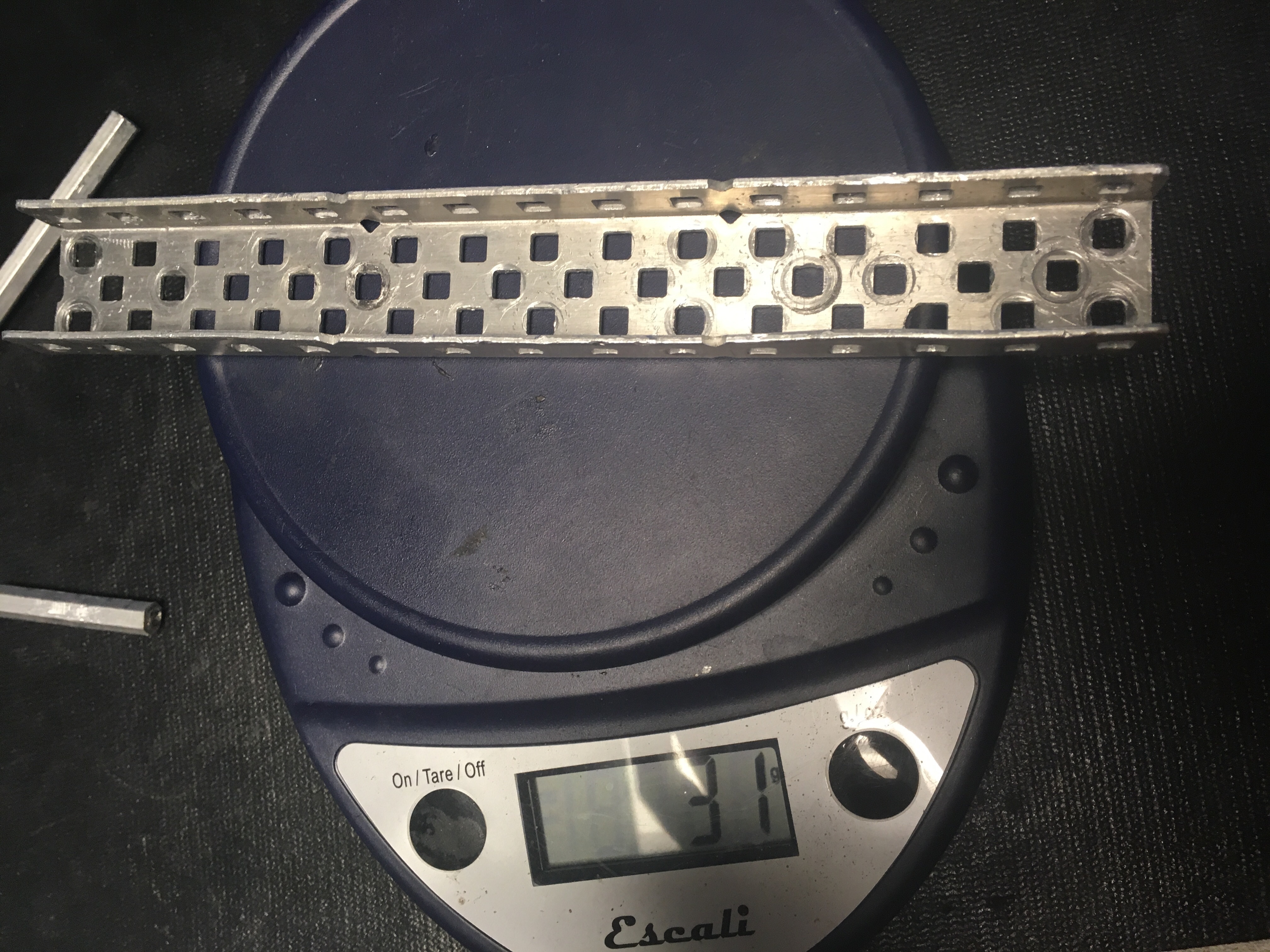

I will be interested to know how much weight is shave off as compared to a normal aluminium c-channel chassis :slight_smile:

I’m sure it’s possible, but trying to attach a lift on there without bending any standoffs will be a challenge… Still pretty cool

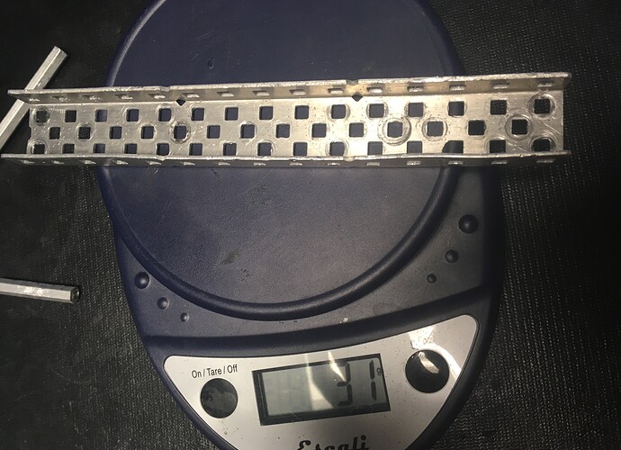

It isnt even lighter. 2 standoffs weigh slightly more than a 1x2x1 c channel of the same length. Since all of the standoffs are doubled up, there is no weight loss. Therefore, this is just a meme.

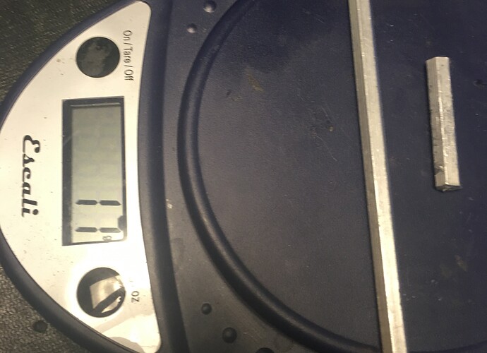

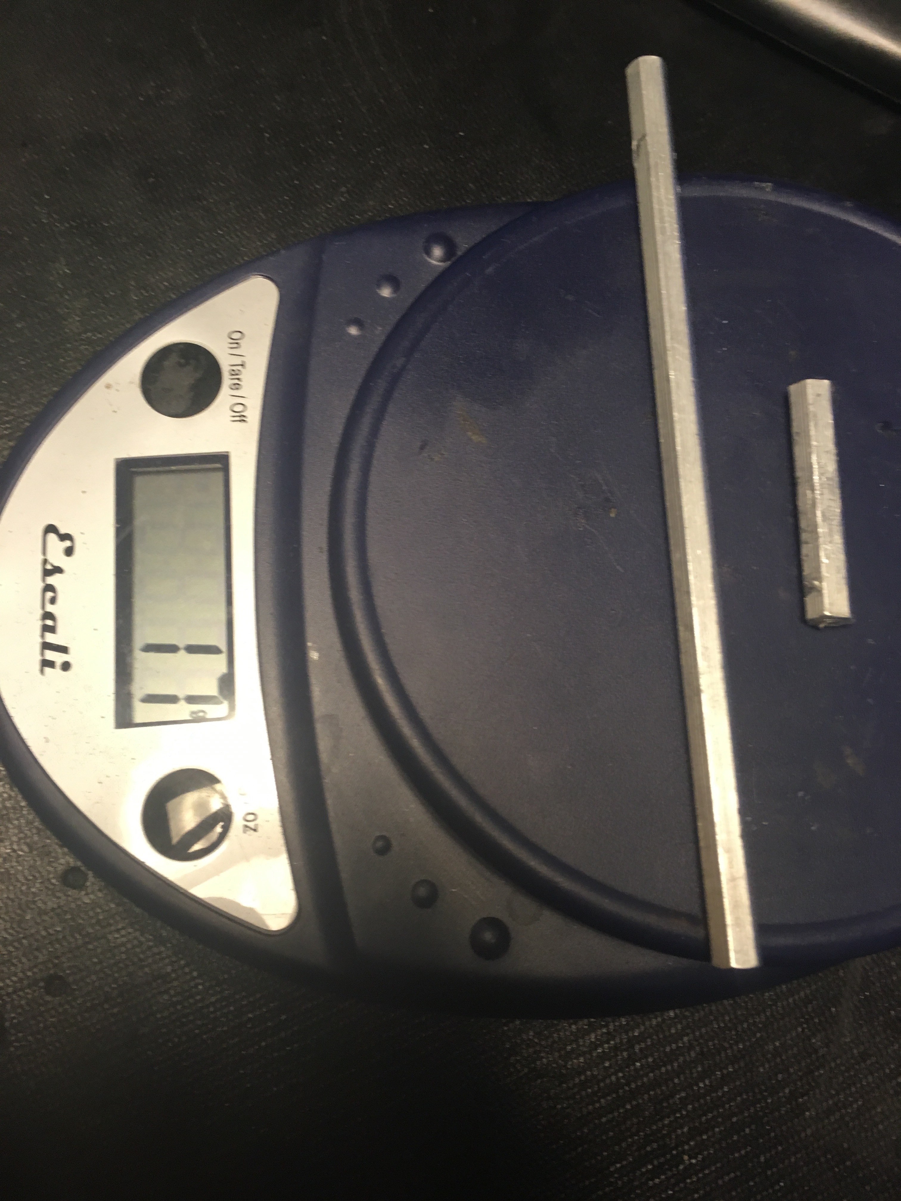

We’ve been through this before. A standoff is half the weight of a c channel of the same length. For proof, I weighed it out on a digital balance. A 2x15 aluminum c channel weighs 31g. 2 standoffs that combine to the length of a c channel is 17g. This is weighed with a 6" standoff and a custom cut 1.5" standoff.
I genuinely approve of this chassis. Would build it if I had the parts.
#7
Yes, but for each side he put two standoffs in place of one 2x c channel, so that thing and a regular chassis with one c channel per side weigh the same.

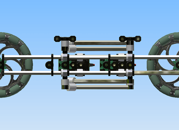

I think this could be made much lighter had you used 1 half c channel for every 2 standoffs, no need for so many pillowblocks too
#11
All of those pillow blocks will almost certainly flex/break. I rather like creative usage of standoffs, but not quite in this fashion although it is a rather cool looking drive base.

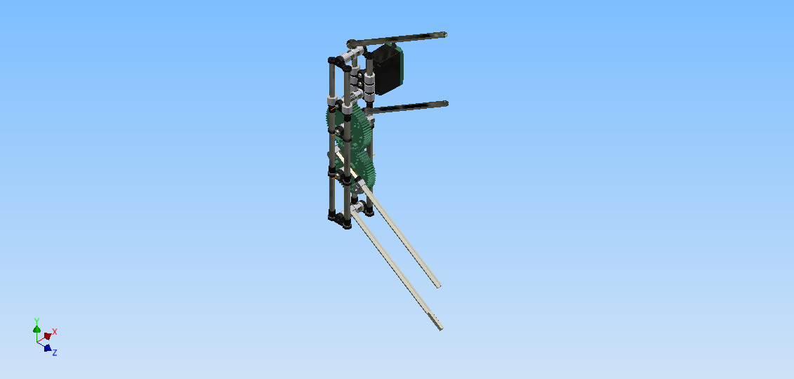

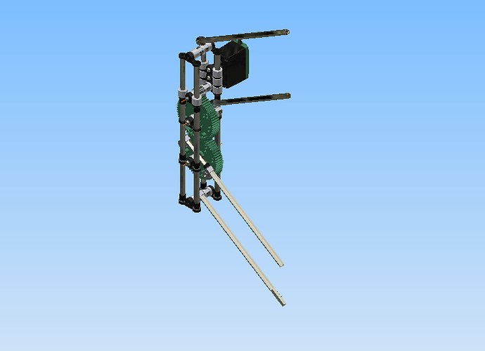

How do you manage to screw the motors in place??
#13
Look at image #2. Bearing flats.

Although the drive ends up looking pretty sick and standoff drive is OP, there are problems that kinda make this not worth it.
  1. The motors being attached to the bearings and the extensive use of pillow blocks is risky. Those will definitely have a chance of breaking or just generally bend, causing slop.
  2. Standoffs have slightly more than half of a C channel’s weight per inch. This means that two standoffs are actually more than a single 2 hole c channel. Incidentally, using two standoffs per side is kinda a no go.
  3. Mounting anything to this kind of drive would be a huge pain, noting that you’d need to add a new mounting point (a new point of failure) between standoffs in every place you want to attach things to.
Good job altogether, though!

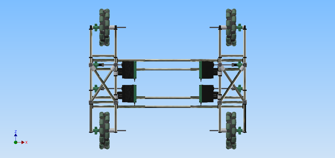

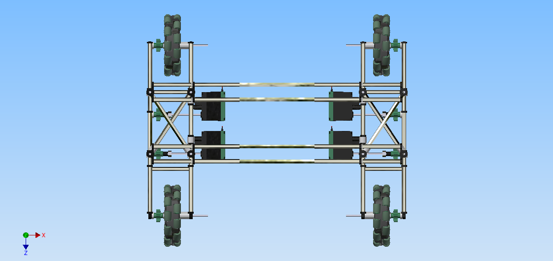

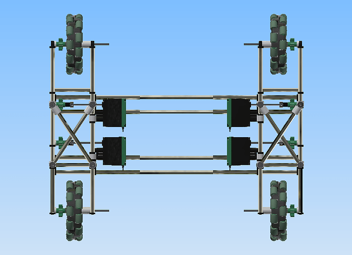

Part 2 is now here
the goal is to have a full standoff bot CAD by the end of the season

part 2 is slightly more functional than last time although I still wouldn’t build it.
