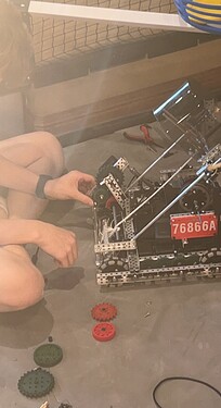

A little leak :wink:
We use a different style of release mech than the other 2 slingshots tho.

I can see how you plan on using the slingshot like a catapult, but I don’t see how it can shoot at far distances. The discs leave the slingshot flat, right so wouldn’t air resistance slow them down.
Is it possible you could record it shooting?
