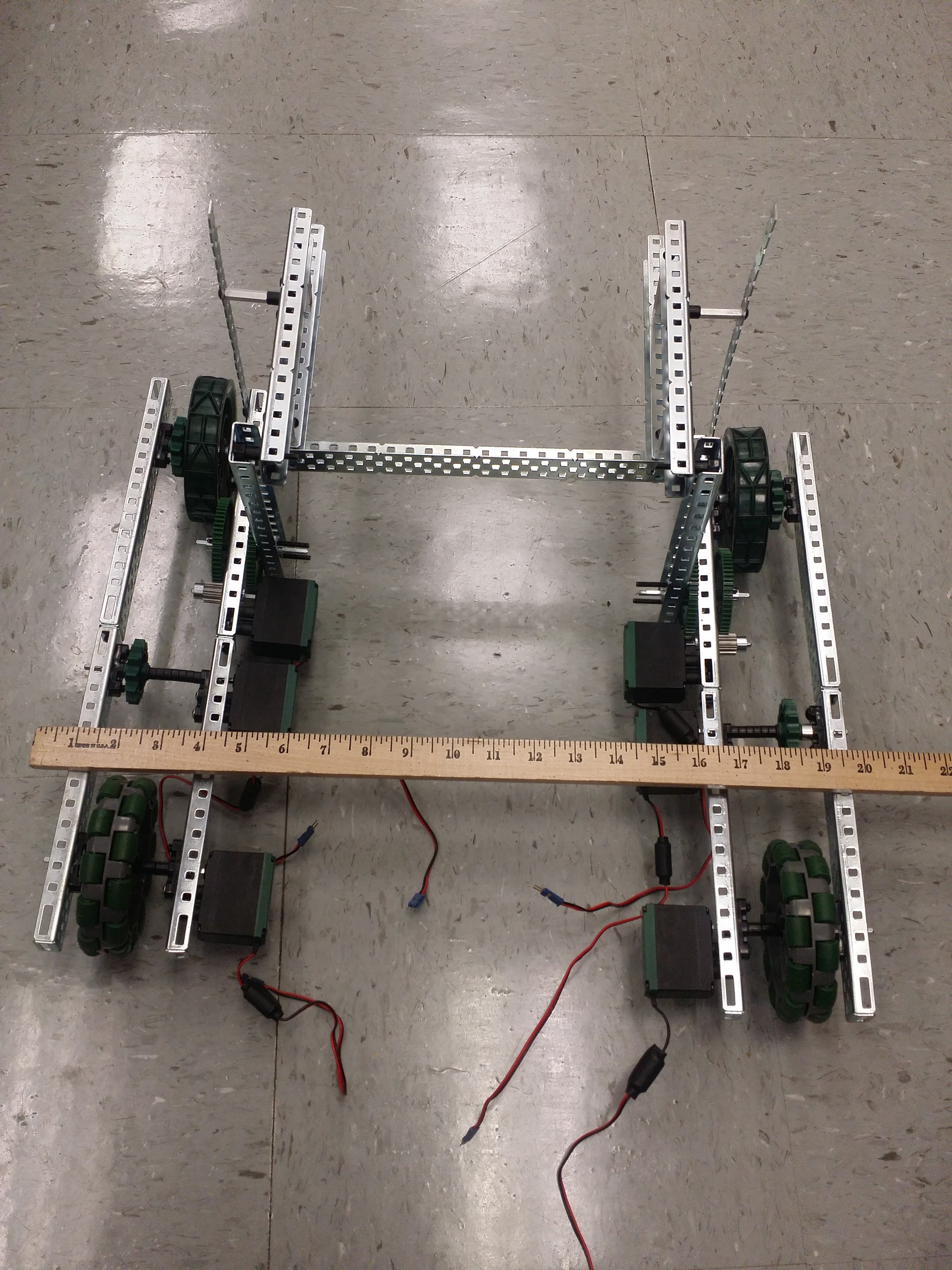

Thoughts on Chassis day 2
This was the previous thread https://vexforum.com/t/thoughts-on-our-chassis/44524/1

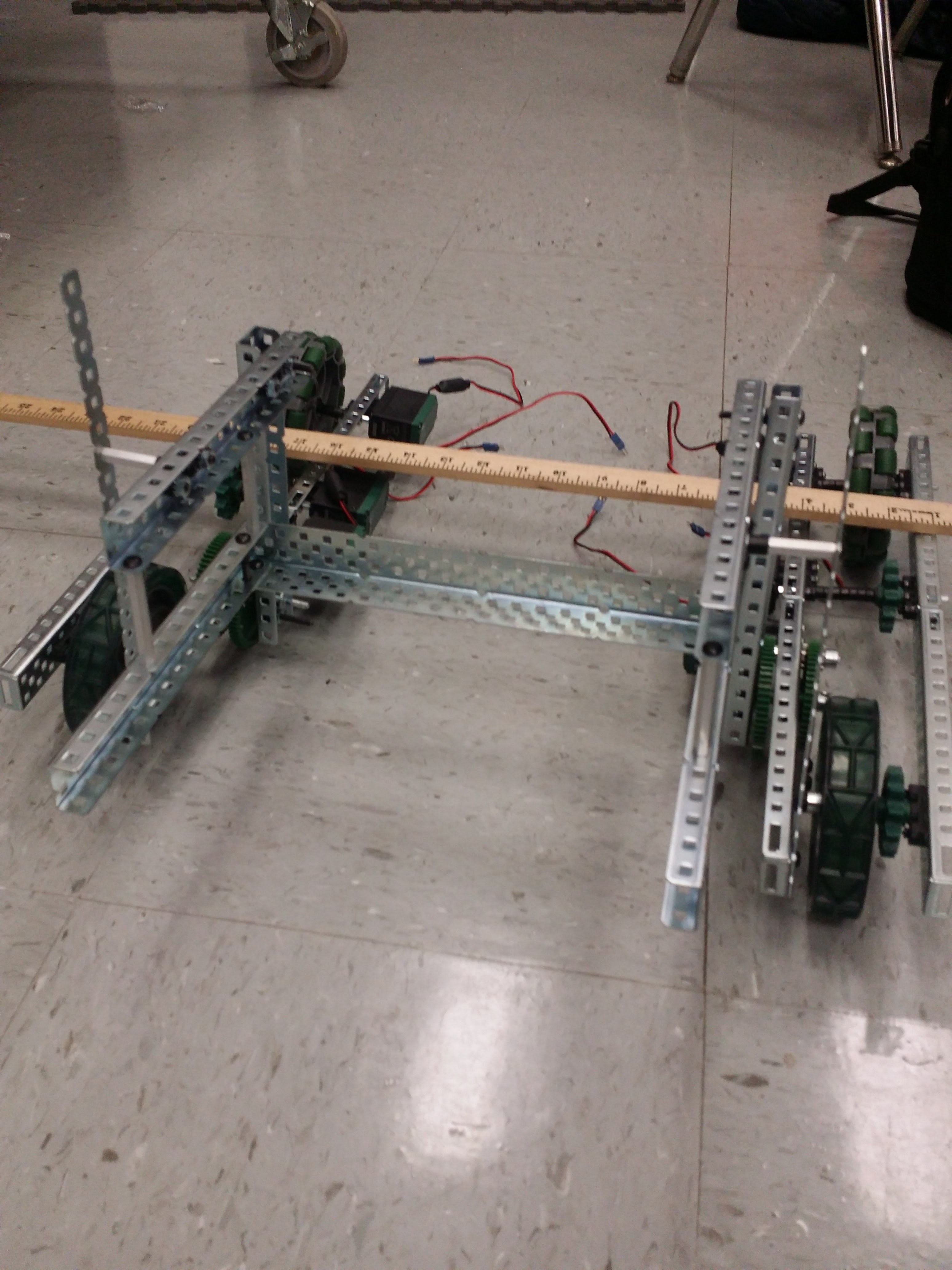

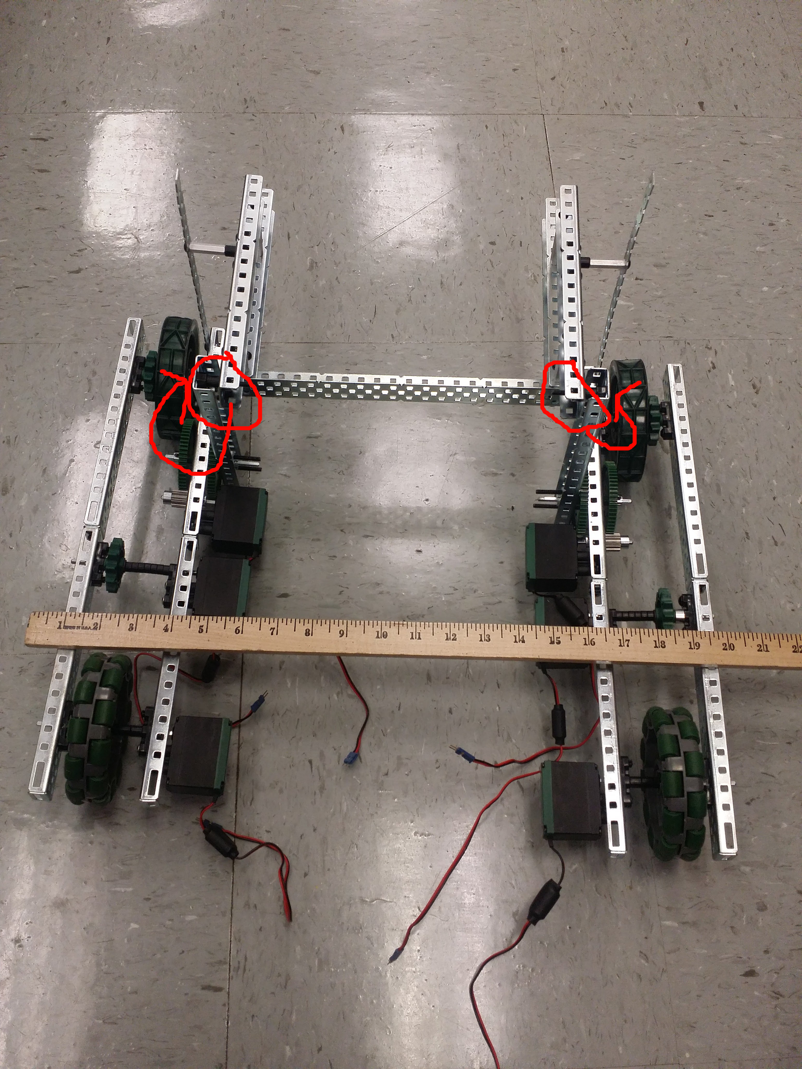

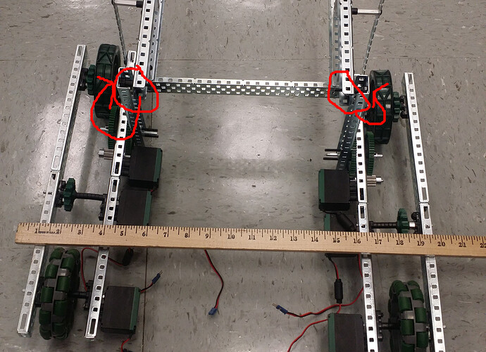

So we took your suggestions and replaced pop rivets, added screw pivots, put nylocks in important spots, and completely changed our mogo design although we’re still outside of regulation. We’ll probably change where the carry part of the four bar is attached to what is shown in my poor paint skills to reduce width.
Any suggestions?

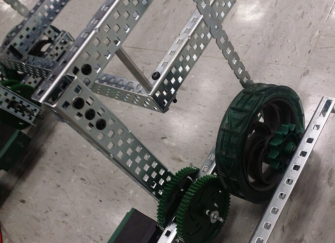

You really really need a c channel going across the robot to support them. Where the ruler is placed in pic 2 would work

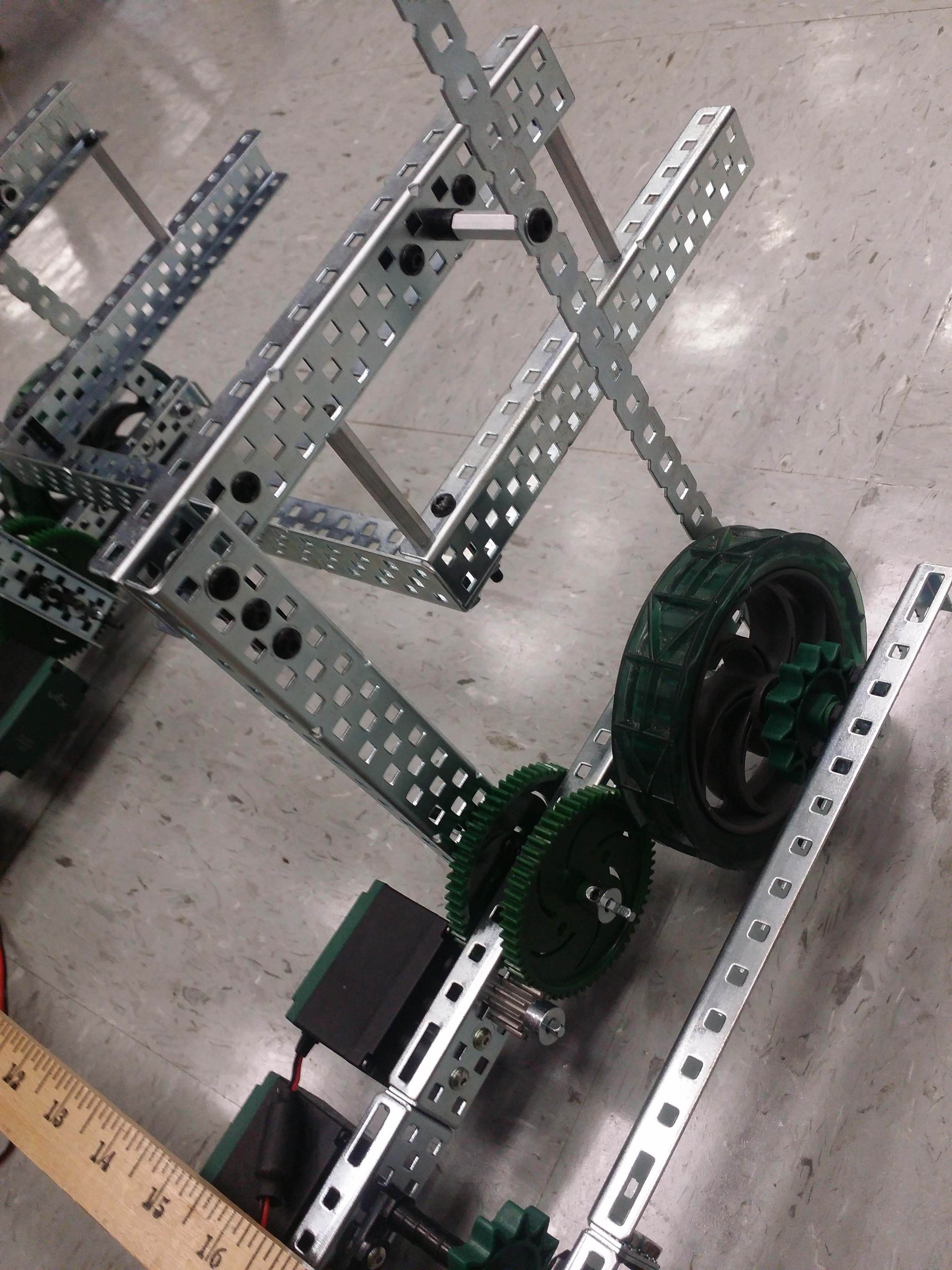

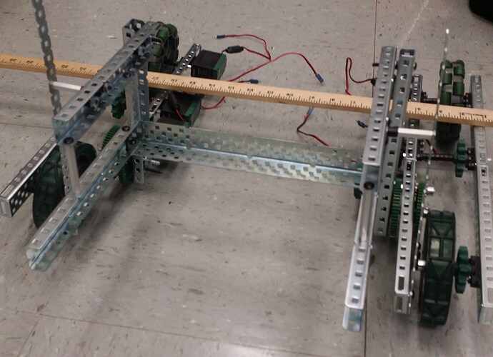

And don’t cantilever the mogo lift. With all of that weight and torque, its just a bad idea.
In general, don’t cantilever anything, it results in bent axles, holes in c-channels, bad motors, and stripped gears.

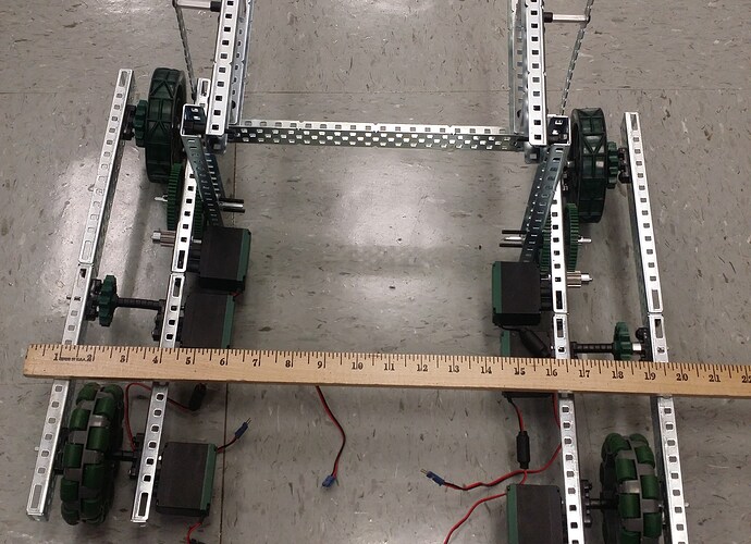

To me it looks like in the second picture that the right side of the chassis is longer than the left side… if this is the case you may want to change that unless it is intentional.
Also, if I am not wrong, the Mogo lift should be able to move further inside the base so it can fit inside the size limit. What I mean, is that the four bar looks like it still has enough clearance to rotate further into the base. You only need to have it fit within the 18 inch limit at the start of a match, and most bots are right around the 17.5-17.9 inch range.
yeah, I had one in the last pic, I just took it off when I was making readjustments

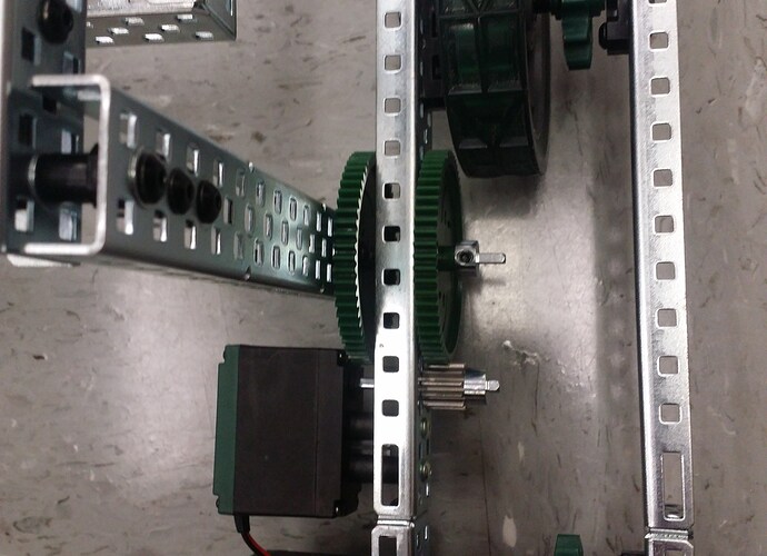

So you think I should extend the axle of the 12 tooth and the 60 tooth so that it reaches the other metal bar?
They were built side by side and are the same length but sometimes it looks off. It should look fine after a cross c bar is attached
Sure, Just make sure that you use bearings.

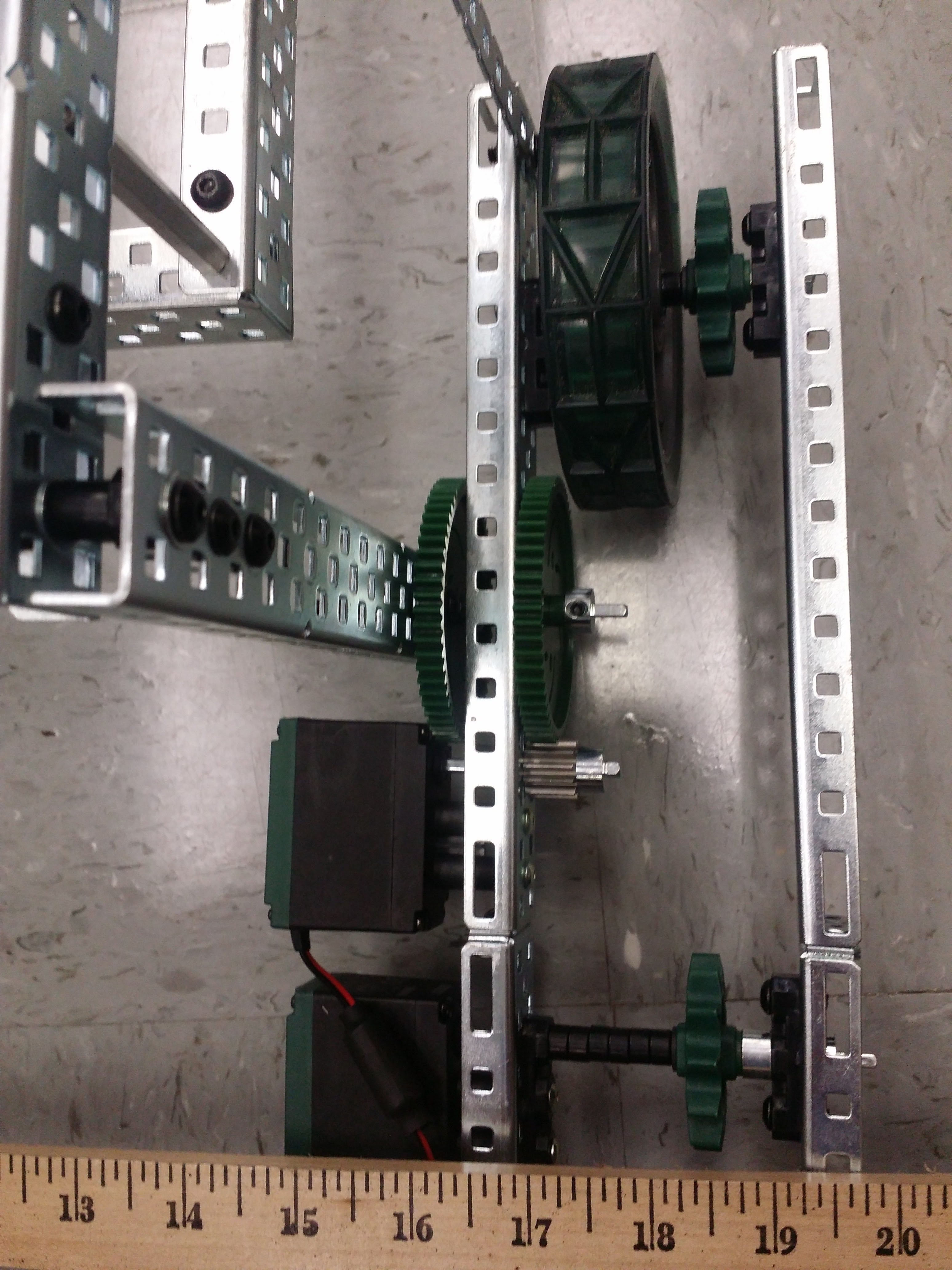

What do you mean by move further inside? Currently lengthwise it is inside the 18 limit its just the width that we are having issues with.
Oh, nvm then. Lol.
Hope this vid will help…
@meng I am always curious about how high profile teams like yours feel about other teams trying to copy your designs. Is this frustrating, or do you embrace it as a chance to help other teams? Also since the video you linked is “reverse engineering”, which is different than copying, I’m not saying that STEM class is trying to copy you, I was just wondering how you feel about teams that literally copy your robots
That’s what we sorta have but their front wheel is not powered by a motor at all which is why they can keep the frame small. We used a chained motor and as a result the supporting metal bar is farther outwards and pushes us past the 18’’ limit
My first impression when I took a quick look at the photos is that there are a lot of wasted space.
And that’s the reason I attached this link to you… hopefully you can take a look at how my guys manage to pack it in.
Oh well… as I said… hopefully it helps… :slight_smile:
I’m guessing he doesn’t mind because the robot someone is copying is probably about three or four generations removed from their latest design. This is a guess on my part, though.
Why use steel rail for the chassis? Aluminum c-channel sounds like a much better fit and is by far the norm. Also using a one-by for one of the bars in a four bar isn’t the most structurally sound, try replaying with a piece of c-channel or cut-c?
I believe in the first thread that @Vyx said they don’t have 35 hole c-channels. But I agree on the one-by’s not being strong. In our robotics team we call them “bendy pieces”. Mostly because when we started VEX earlier this year we had no idea what anything was called so we also call shaft collars “locking pins” and washers “small spacers”
