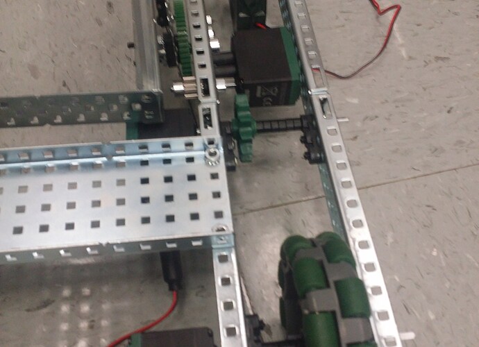

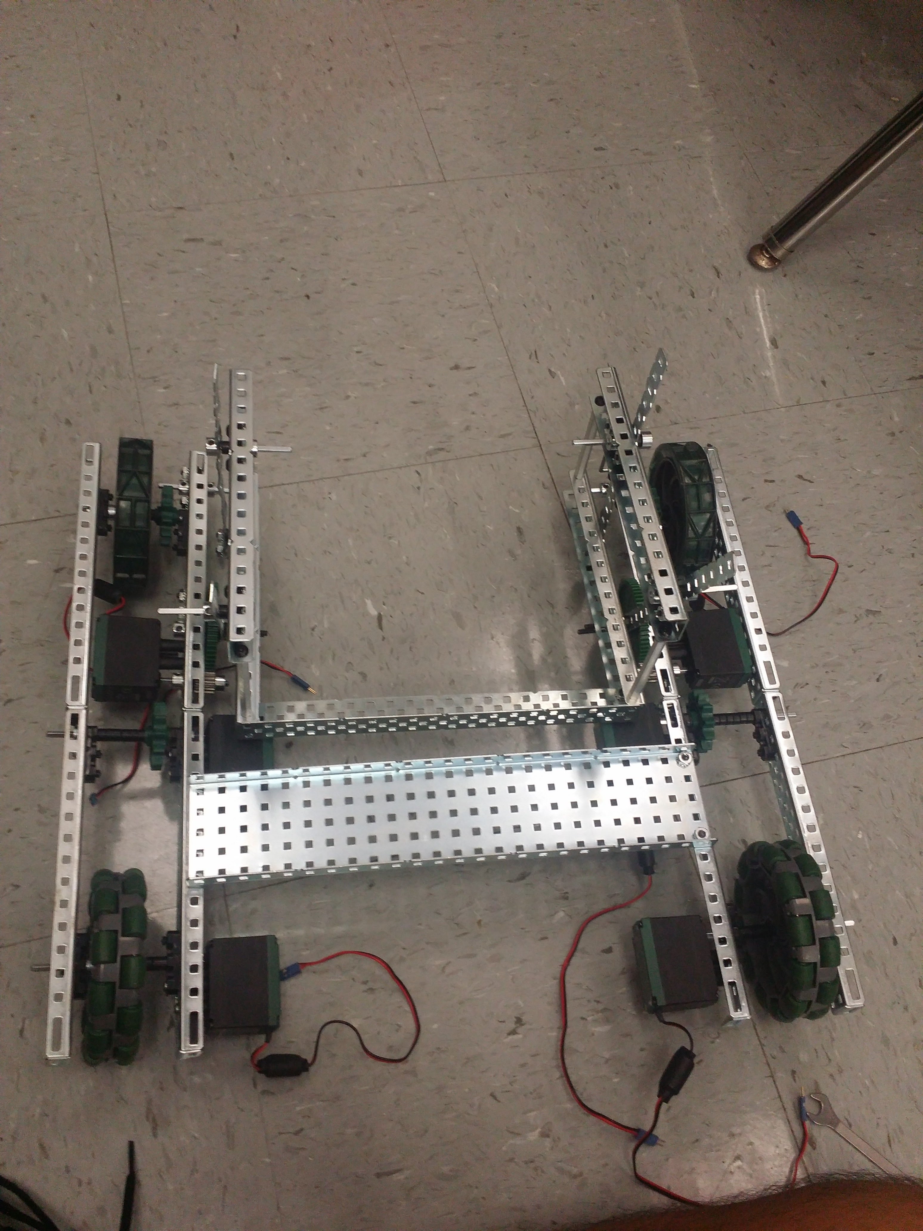

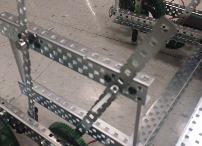

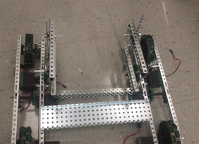

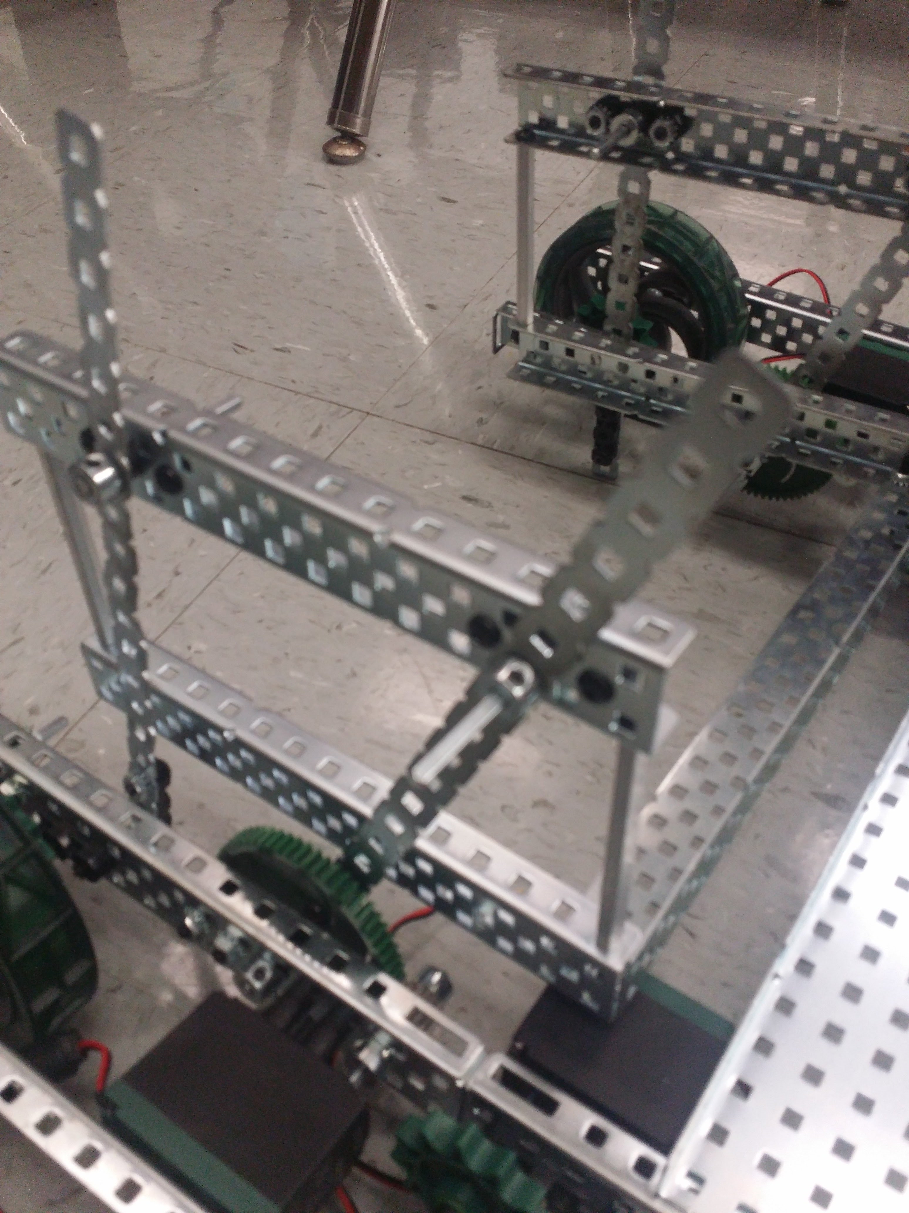

This is what we have so far. Any recommendations? We’re skimming on the size limit horizontally and also aren’t sure if using the wide c channel is the best way to connect across. The four bar mogo lift has an arm detached from its pivot point in the pics but we got a place for it. We’re using a chain for the front wheel, it just wasnt put on.

Instead of using axles as pivot points on the 4 bar lift, I’d use screws. Use nylon spacers/washers in between each metal-on-metal contact point to reduce friction.
Do you have a tensioner on the chain linkage that connects the front wheel to the motor? Seems like the chain will touch that other motor, and that’s never any fun.
Eeeeew, steel.
No but seriously, if you want to be competitive, only use aluminum.
Not having proper support on the outer rail is arguably worse then having cantilevered wheels
That 1x bar on your mogo intake is going to bend
Not using screw joints on the logo lift, smh
Please don’t ever use pop rivets
No nylocks anywhere, unless those keps nuts are ridiculously tight, they are going to loosen
What @antichamber said but also:
-use standoffs or more c-channel between the 2 outer rails that support the wheels
-on that axle with the sprocket and too many spacers, maybe use a shaft collar so you can have spacers for other things
-idk what internals you have your motors on, but I recommend HS
-for the outer rail just use a 35 hole c-channel instead of 2 rails connected
