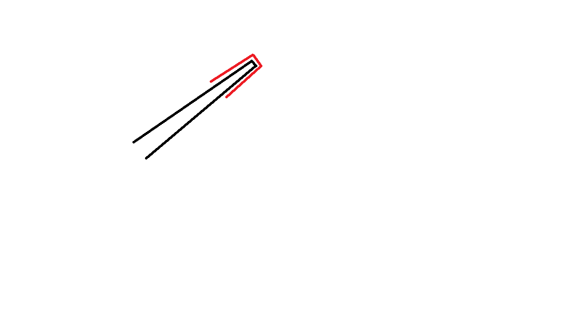

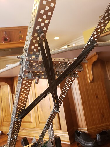

When our robot’s third stage for its tray flips out, instead of flipping out, it moves in the opposite direction and embeds itself inside of the second stage, preventing it from unfolding.
See this video
Edit: our tray is designed to unfold after intaking a cube.
In your video, the rubber bands are held the same distance away on both sides.
This means that the force is pretty much equal on both sides so they cancel out and the tray won’t flip out. Instead, you need to offset your banding so that the top part has less distance to the turning point and your bottom part has more:
This way the bottom part has a greater pulling force than the top causing it to flip out better.
Your bands are also way too close to the turning point. If they are held farther away then the bands would have to exert less torque to flip out the tray (Although there is a point at which they are so far apart that they just break, you would have to figure this out experimentally).

Try to include a stopper so that the stages can’t fold into each other. We had to do that for a previous iteration of our design and it worked well.
It still won’t unfold until it reaches a certain point. I can fold it down to near parallel and it still won’t unfold.
As long as the stopper ensures that the stages don’t fold parallel, the force from intaking cubes should be enough to push the tray more, allowing the rubber bands to take over in unfolding.

I do notice that when it’s folded down the third tray isn’t parallel with the second tray, maybe you can make something to prop that up more near the hinge so that flipout is easier?
Connect the rubber bands to the c channel brace on the very bottom of your third tray. This is what I did for a while and It worked well.

I can think of 2 ways
  1. loosen the 3rd stage’s grip on the 2nd stage, by expanding it a bit, bending metal, etc.
  2. place weights on the end of the 3rd stage; the momentum of the 2nd stage opening should be enough to pull out the 3rd stage
The way we made our 3rd tray flip out was to make it so that the rubber bands go above the joint the attaches the 2 & 3rd tray. We did this by adding c-channels that could stop the tray as well as make the rubber bands go above the joint.
