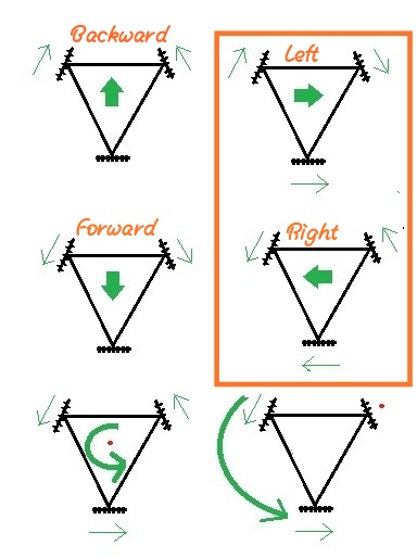

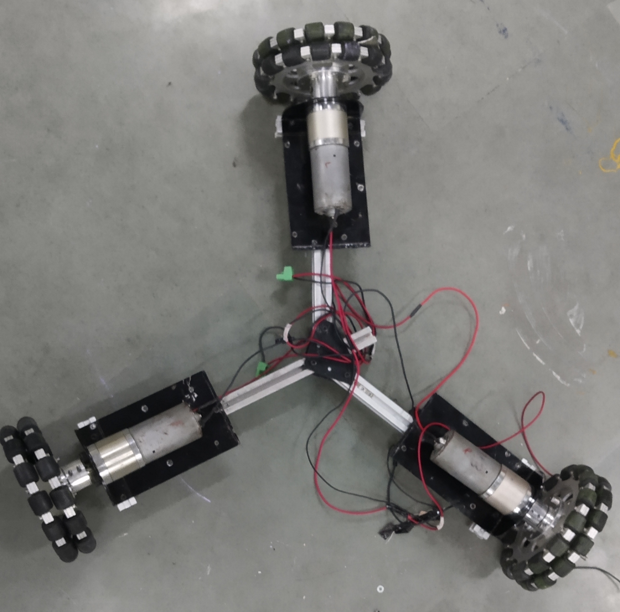

I am working on a three wheel Omni drive. It’s forward and backward motion is pretty straight but left and right is not at all straight. I have tried changing rpm of each motor but it isn’t helping. I want to know where I am going wrong. Also is there any way to avoid skidding of Omni wheel ?
Can you explain what you mean by not going straight when turning? I’d just assume that if you want to turn in place, you just have all three motors spin in the same direction. If you want to drive forward while turning, I’d assume that to start out, you could just have the same code to drive forward, but you use the third wheel to turn in a direction. Ultimately you could probably make a more efficient equation, but for turning, that should work.
If you want to reduce skidding, you could implement a type of slew control, where you don’t feed all the current instantaneously to the motor, but gradually ramp up the power.
I am referring to these directions. I was talking about left , right mentioned in the diagram.

I’m guessing it is a combination of uneven geometry and uneven motor speeds. Do you have encoders on the motors so you can ensure speed control?
There is an error of 0.5 -1 cm in the dimensions.
Encoders aren’t there but I used tachometer to get the base speed of motor.
Motor 1 -310.7 rpm
Motor 2- 399.4 rpm
Motor 3 - 390 rpm
I have taken care of this difference in the code .
Motor 2=Motor 2 * 0.776942356
Motor 3=Motor 3 * 0.794871795
Is this a correct way to deal with it ?
The thing is, not all motors are even or linear so the only way to deal with it is real-time feedback from from an encoder or similar to accurately control each motors speed.

I’m thinking that in order to strafe left or right you’ll need to have one wheel perpendicular to the strafing direction , and have the other 2 wheels do the pushing
