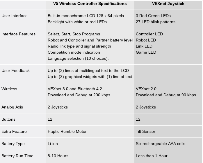

I was wondering if there was a tilt sensor in the controller and how I would be able to use this in programming.
here is an image image

this is 4 the v4 controller and cortex
Just by looking at this, I would say there’s no tilt sensor in the V5 controller. Tilt Sensor is listed under VEXnet Joystick and Rumble Motor is listed under V5 Wireless Controller.

http://help.robotc.net/WebHelpVEX/index.htm#Resources/topics/VEX_Cortex/ROBOTC/Remote_Control/vexRT-Accel.htm
o this is the tilt sensor. I thought you could tilt the controller and it could controll the robot
Yes, did you read the thing I linked you?
yes but is this the code to make a robot move based on the degrees of the controller to the ground?
Yes, this is the code you need. My teams have tried it and found it is not a great way to control the robot in competition. They would get too excited and over-control the robot.
