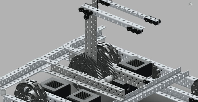

I didn’t look at the video but what I did is I did a 1:7 ratio for the tilter and used a green insert for the 84t gear and put a screw through the big gear. Then I just used 12t gear on 100rpm with an HS axle and this setup works well enough to get at least 12 cubes.
Interesting. A 1:ratio with 100 rpm can get 12 cubes? I’ll have to look into that
Sorry I don’t have any good pictures of my robot right now but this is a CAD of my tilter. It doesn’t skip and can push more than 10 cubes. It is a 1:7 gear ratio and the motor is a 100 RPM.

We have a 5:1 100RPM tilter that works for 9 (maybe more). Make sure you use screw joints where possible, and try replacing the gears because they might he stripped. If you are using a parallel 4 bar for the tilter/tray, consider offsetting it because you can increase its mechanical advantage that way.
