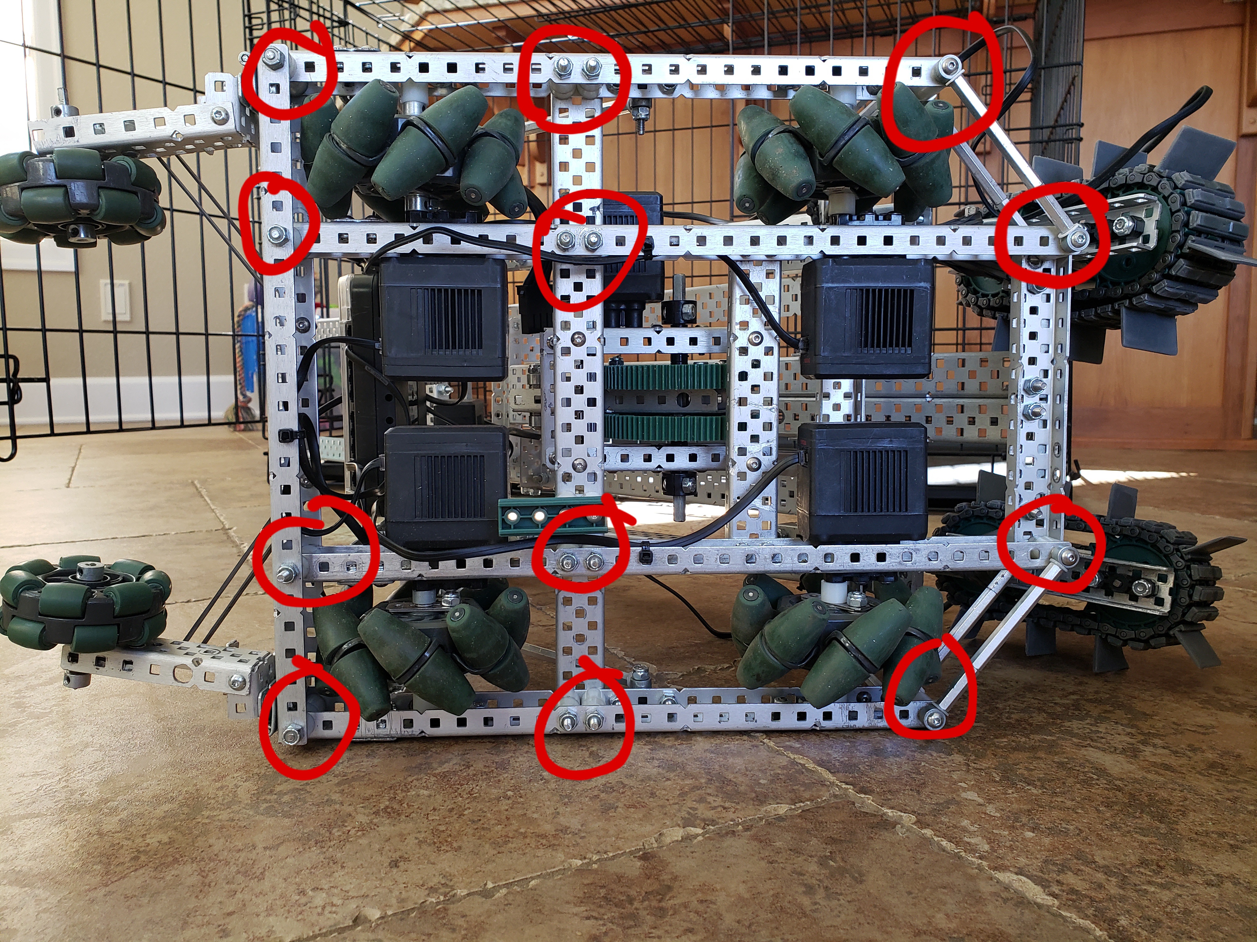

To make stuff constrained and rigid you just have to use parts like shoulder screws and make sure that you have plenty of bracing. Bracing can come in the form of spacer boxing in crucial areas and boxing a c-channel with another c-channel in areas that must not twist. I will post here a picture of my extremely rigid drivetrain from last year. One thing I would generally avoid is connecting major structures by stuff like standoffs because they are subject to loosening by vibration (loctite could negate this) and can bend the metal somewhat easily if hit. They have their roles though so don’t be afraid to try them.

20201003_124520
The red circles represent everywhere there is spacer boxing. This robot’s drive was built in about 3 days of work from 2 people without any CAD (didn’t know it then). Just by these pieces of bracing it is essentially 100% rigid (I cannot make anything flex using my hands) and far sturdier than necessary. Sure it would get damaged if it fell off a table or got hit by something, but nothing that will appear in competition can affect it. The screws are tightened enough that I highly doubt pieces would get out of true even after many competitions.
