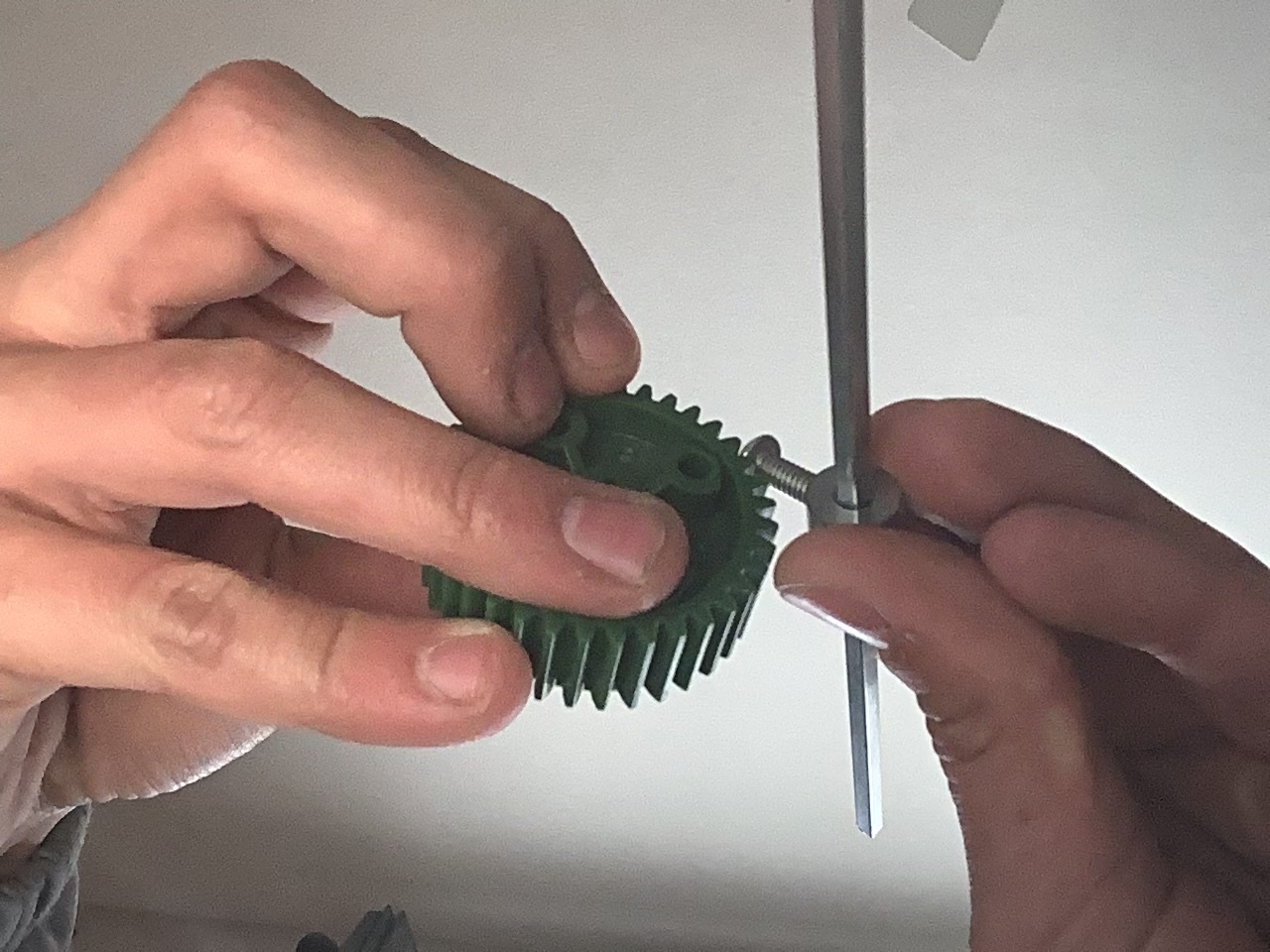

we need a tiny ratcheting mech, and ive watched this video
but i cant figure it out, and i need help. does anyone have any suggestions for 36t to 12 t gear ratcheting mech

that mechanism just pushes a screw hear into the gear, because one side of the screw is rounded and the other is flat, it can spin one way and not the other. there are other videos on that type of ratcheting mechanism, here is a good video on a similar ratcheting mechanism that does a good job at showing the concepts behind it
@Sylvie has a good video on ratchets as well that i would recommend
(edit: i posted the wrong video, should be fixed now lol)
I understand how rachets work. I’m having trouble making one small enough for a 36 tooth gear to a 12 tooth gear.
I would highly suggest looking at Kepler electronics video on ratchets. Or constructing something like this, just with rubber bands pulling the bolt towards the gear.
If I’m not mistaken, @7996B’s second video demonstrates a technique that could be mounted on the 36 tooth gear and would ratchet a 12 tooth. You would need an extra gear in there (or two if you want the rotation to remain the same) to connect to the 12 tooth, but this mechanism could remain fairly small if you build a stacked gear train.
