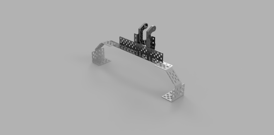

We have most of our robot built but we need some different ideas for a Mogo carrier. We have a few of the most popular ideas already, like the fork carrier that is on the Moby bot, but none of them work for our bot. Is anybody else trying something different or unique?

It really depends on what you are going for though, If you want to hold onto a mogo with stability and to put rings on it amoby bot lift or ITZ lift seems great. If you wanna lift up the mogos a claw seems to work best. I had found that its hard to use a forklift to put mogos on a platform and that’s why we ended up making a claw. The little polycarb lip on the platform is annoying for this. The DOGO lift looks cool but difficult to quickly hook the mogo with.
thanks for the videos guys, they should help very much. We’re trying something a little bit like the Harvard-Westlake robots’ main goal carrier. Here’s what we came up with: mogo_carrier_2021-Aug-20_08-09-35PM-000_CustomizedView17137713314
