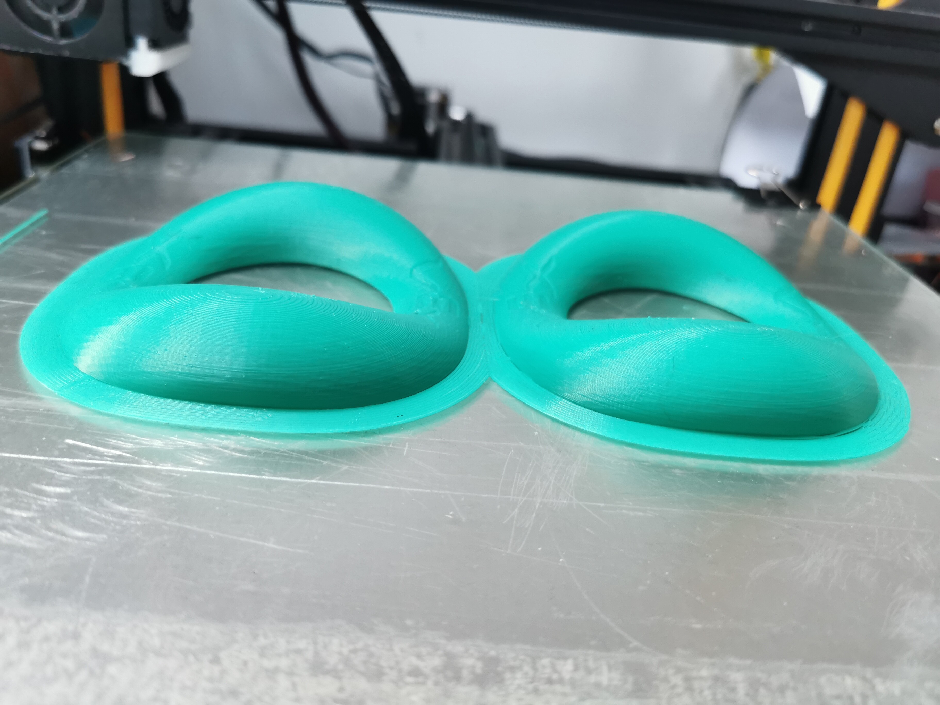

I modified the ring CAD file so that it can easily be 3D printed on an FDM printer by printing two solid, halved sections of the ring and then supergluing them together. This was an absolute pain for some unnecessary reason (thanks to SolidWorks). Anyway, I uploaded the files on Thingiverse so that you all can 3D print one before you get the actual thing in hand. I hope this is helpful and if you have any issues with the STL files or want some more variations, please let me know.

Thank you! It might just be me or is there only one half of the ring? Also is it possible to add this solid ring for those who want an easier and stronger single body print. I just did a sweep in fusion 360 to fill it.https://www.thingiverse.com/thing:4867436
I took the ring, cut it in half directly at the midpoint, and made it solid so that it could be printed face down easily on an FDM printer. If you print two of them and turn one 90 degrees and sandwich them together you get one full ring. If I am mistaken, and that doesn’t actually work, then let me know and I can add in the two halves. I will also add the solid ring.
Oh that’s very clever! It wasn’t making sense until I did it in fusion 360. Thank you!

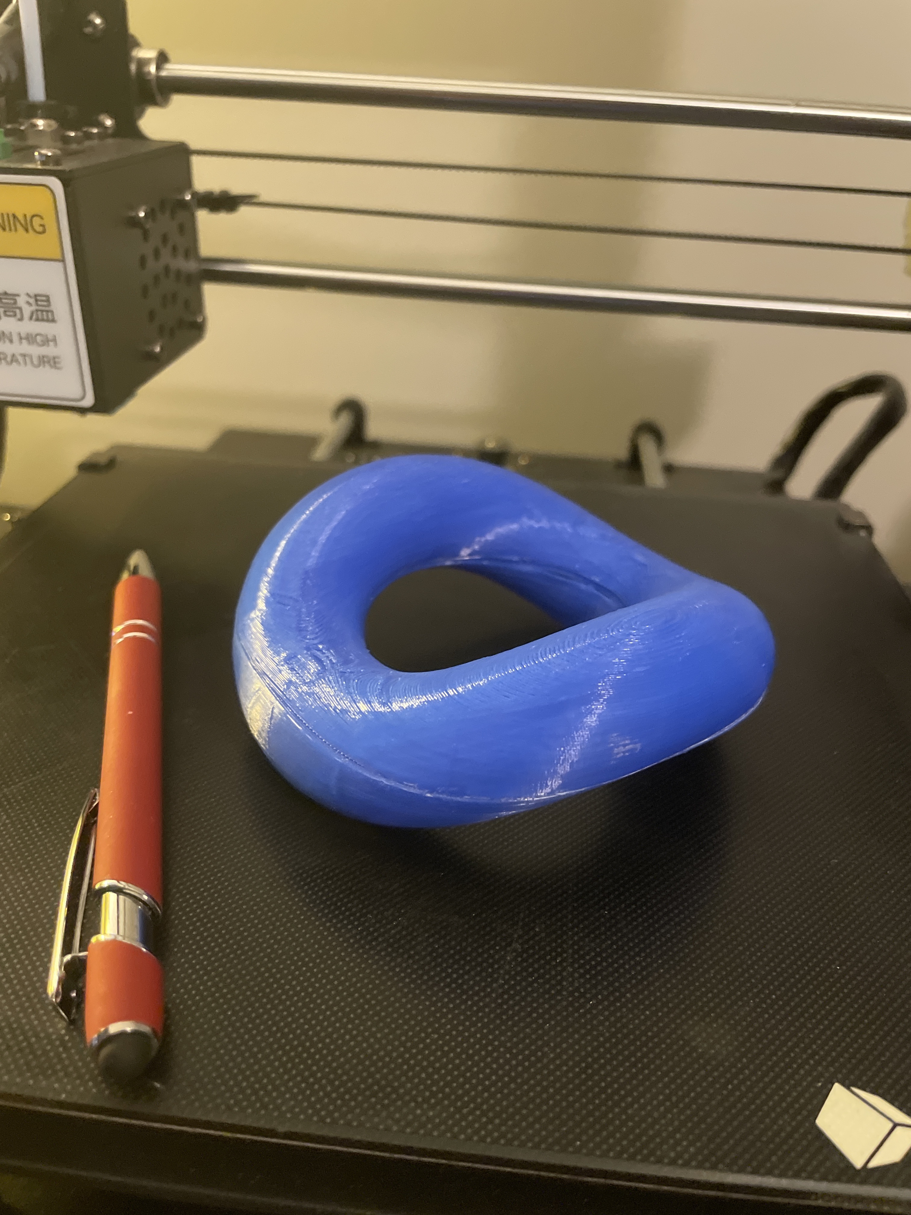

Thank you so much for the files! I printed one with my iffy AnyCubic within 3.5 hrs and glued them together. (Pen for size reference) Came out great! Thank you! image

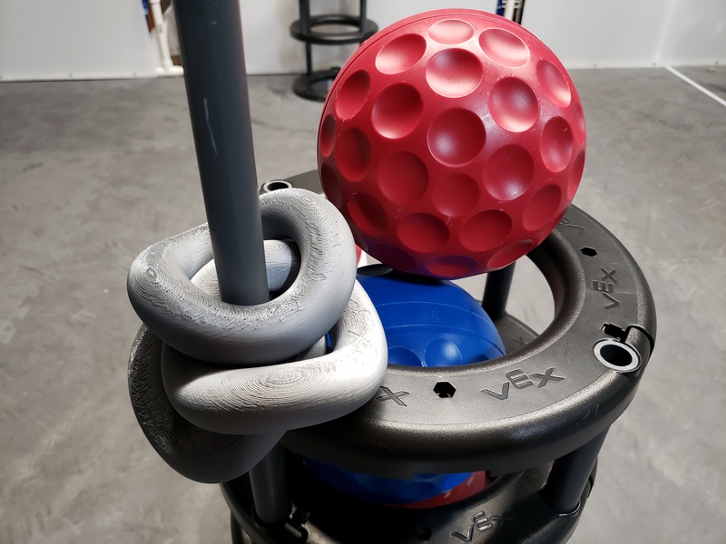

Thank you! We attempted to print whole with supports. Not considering the waste of material (raft+supports) and time (took 4 hours for one) it worked. Printed 3 as we were curious about how these stack and if they auto-stack neatly like pringles do. Hard to tell because our prints came out rough (supports) and there is a lot of friction. Assuming the injected ones will be smooth and slippery. Also, for all the math gurus: what do you call the ringle shape. It’s a torus in a hyperbolic space so… hyperbolic torus? Thoughts?
