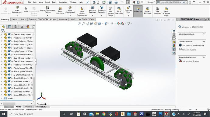

Well since my team is not allowed to go back to school until August, our summer goal is just to CAD out the robot on Solidworks, and possibly have our programmer create the code for driver control.
(Concerning the third wheel, the see-saw in the game was giving my team Turning Point Vibes)

you’re not going to need a third wheel like that. in fact, the clearance with the ground will increase when climbing a platform, so that wheel there will almost certainly never make contact with anything.
Hmmm do you think I should replace it with another omni-wheel or just remove it in general?
Unless you want a drive that can’t be pushed from the side, then I’d just get rid of it.
Hmmm ok thanks for the advice
Thanks @YogurtBoy

couple of suggestions for your cad
  1. turn on large assembly settings on the top right corner. The CAD will run a lot smoother
  2. The gap between the 2 c channel can be greatly shortened. 3 holes i n between are more than enough space for just the wheel / thin gears, 4 if you’re doing chain or HS gear. It simply conserved space since mogos are huge
  3. Your front wheel is currently not powered, you might want to add another motor or add a chain
  4. Center 2.75” is not needed, I’ll suggest either changing to 3.25” traction or just remove it. You can drive straight up the platform this year since the ramp goes straight to the ground
