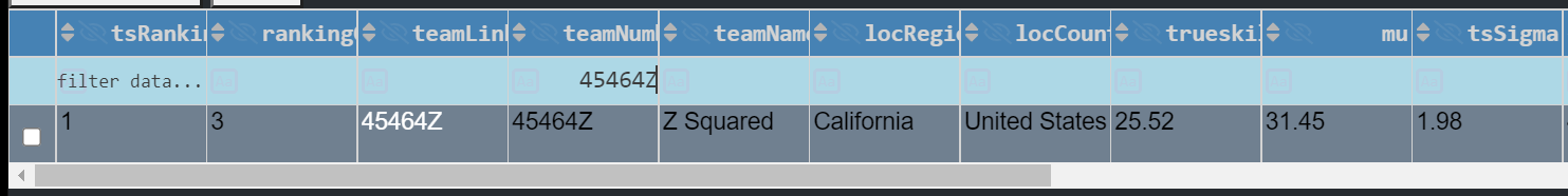

Under “Wide Rankings”, let’s look at 45464Z:
So we see the TrueSkill is 25.52, and “mu” (the mean) is 31.45 and “tsSigma” (the standard deviation) is 1.98. TrueSkill is defined as: mu - 3 * tsSigma so 25.52 = 31.45 - 3 * 1.98
Why choose 3 times the standard deviation? Basically to be able to say with 99% confidence that a team’s TrueSkill is at least this value. 1 Standard Deviation would give you a 68% confidence interval, and 2 Standard Deviations would give you 95%.
The Match Predictor page displays the full Normal Distribution and reports the “mu” number, not the TrueSkill. Perhaps misleading on my part.
