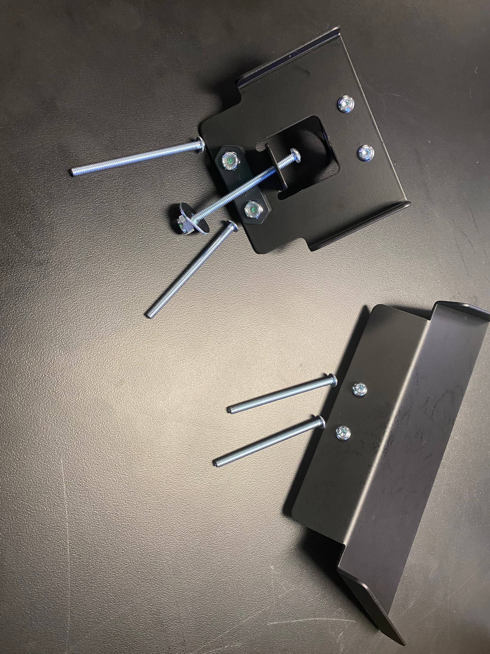

First of all, all the shorter bolts that work on the regular competition field need to be replaced by the longest bolts that came with the field elements to be able to secure to the portable field walls.

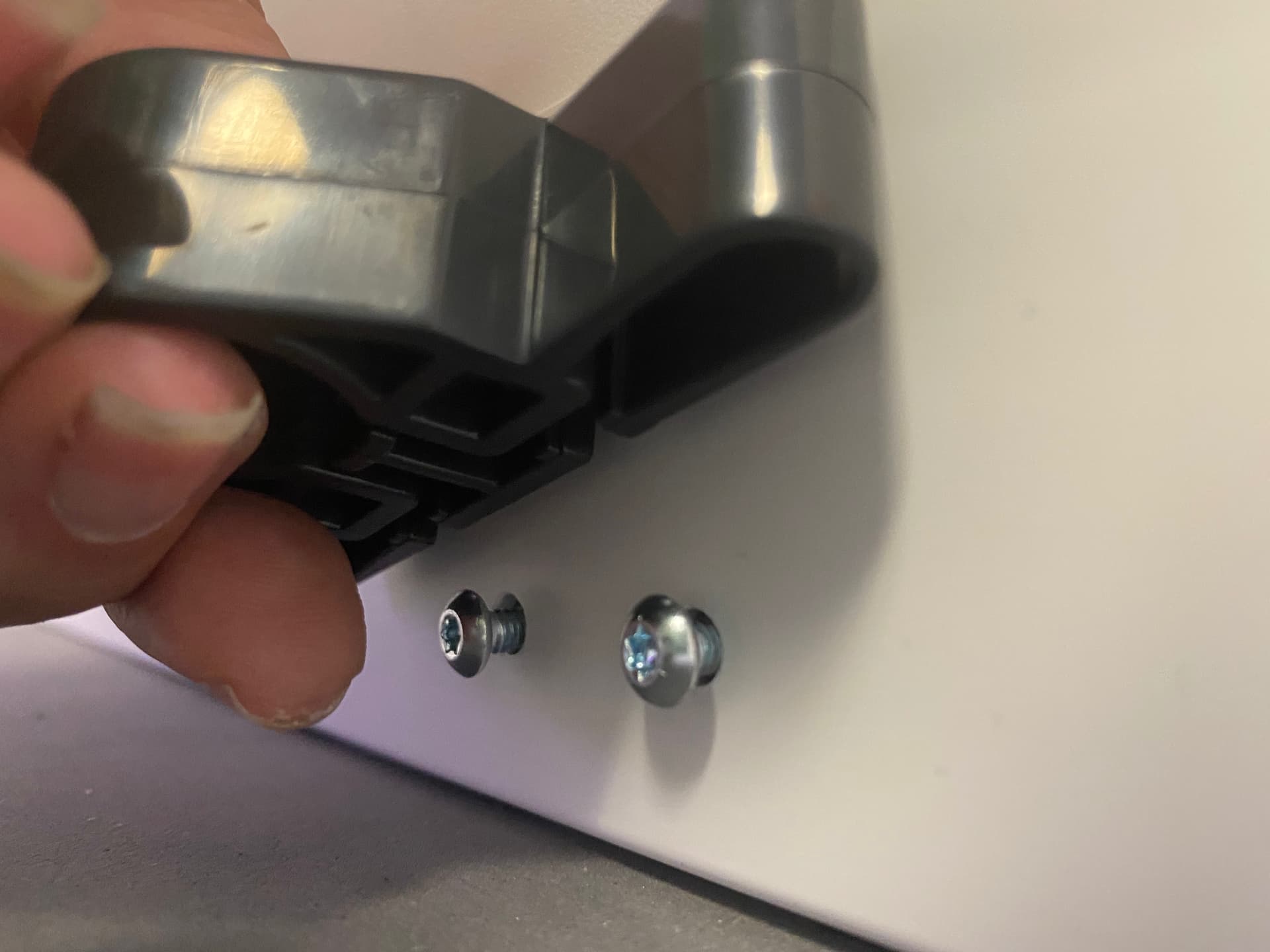

Where the net post attach to the wall, again use those long bolts, but on the bottom attachment point, to attach, I found we had to put the long screws on the inside with a backer plate on the outside, then slide the bottom net post support over the heads of the screws.

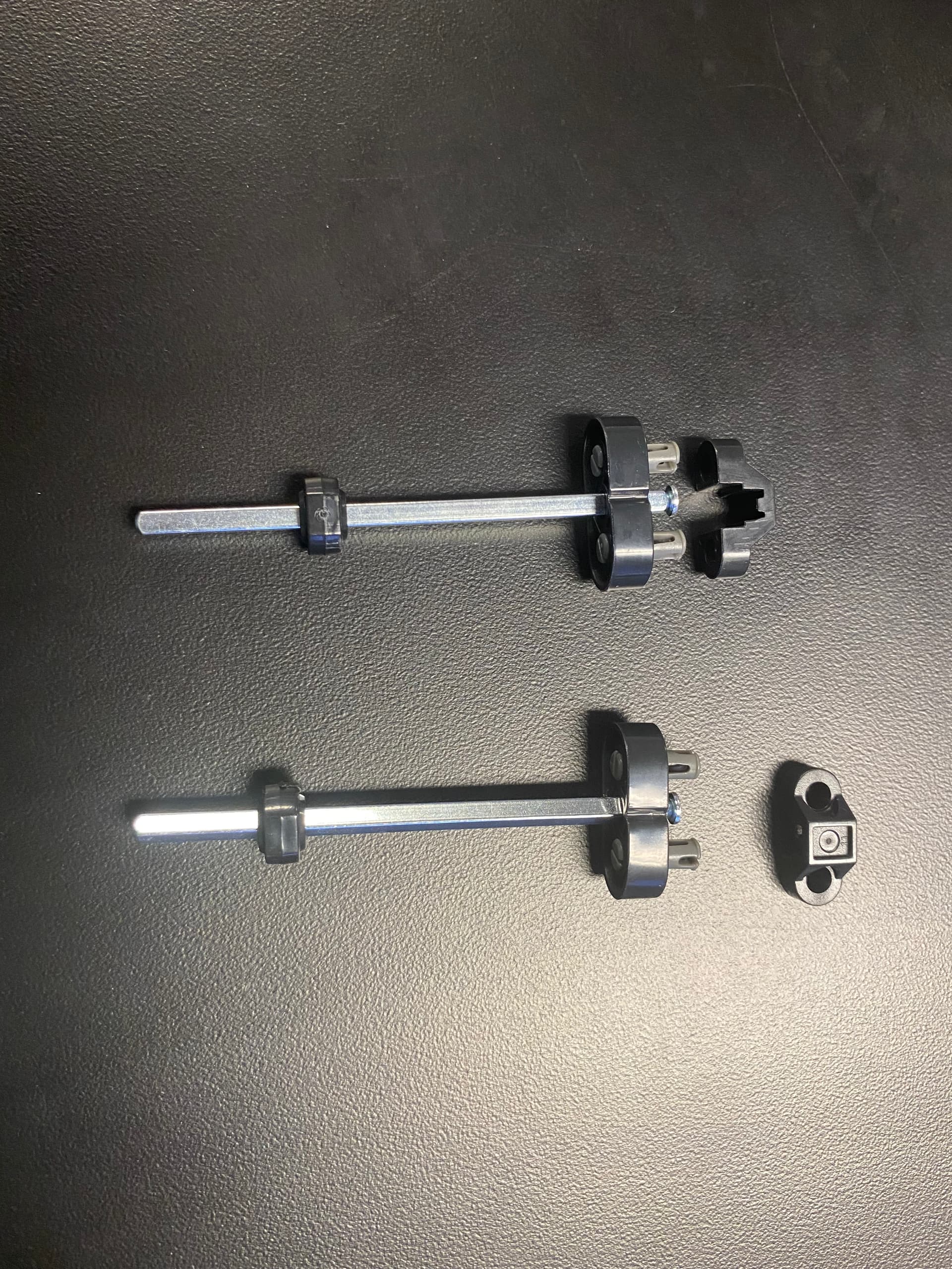

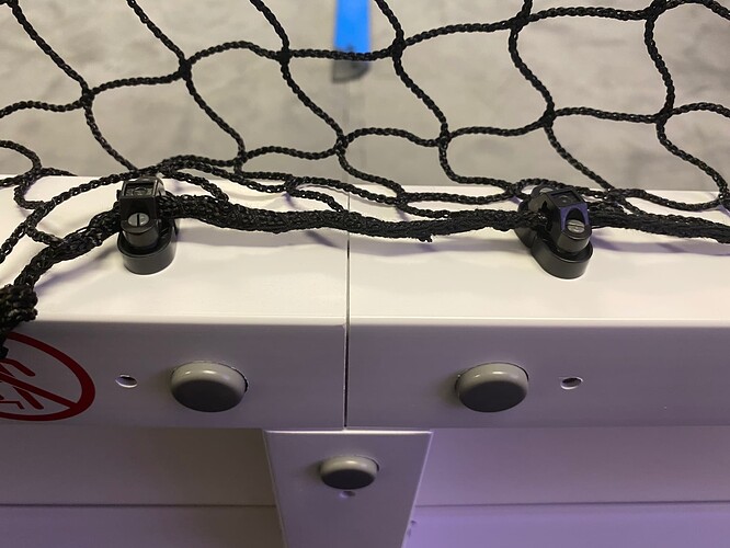

To secure the net was the trickiest, since there was no way to attach the rubber net clips. Instead, there were these nail head axel looking things along with some 3 hole widgets, friction connectors, a bridge shaped 2 hole clip, and some rubber axel collars. We figured out to put the nail head axel through the 3 hole widget, drop that assembly through the holes in the net area, use the bridge shape clip to the 3 hole widget to the net utilizing friction connectors. Secure this to the rail with the rubber axel collar.

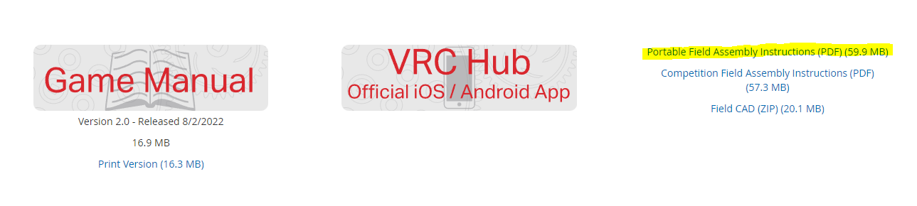

Here is the link: https://content.vexrobotics.com/docs/2022-2023/vrc-spin-up/PortableFieldPerimeter-AssemblyInstructions.pdf
I missed it my first time through too.
