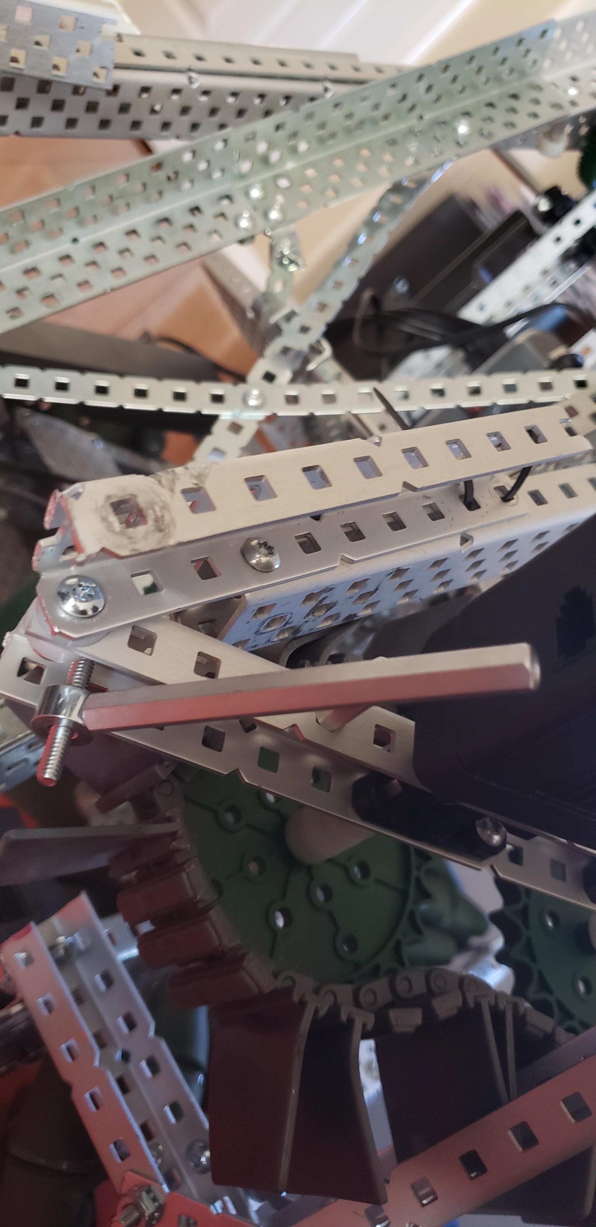

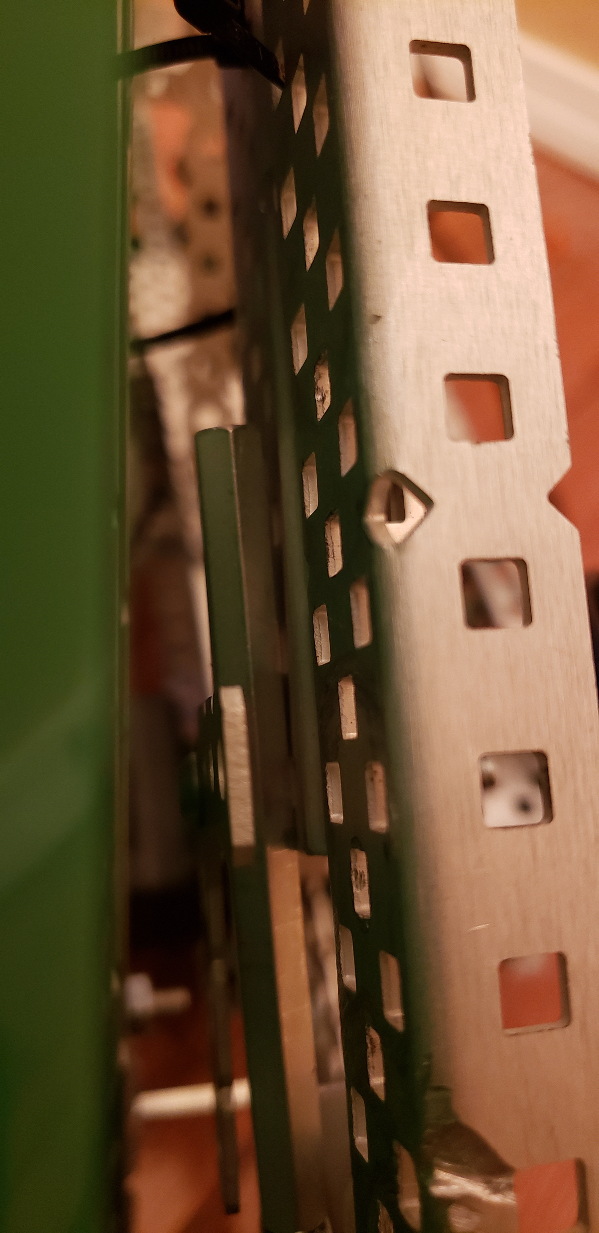

A locking mechanism might help you to prevent the intake from being pushed outward too much which should help to grip the cubes better and hold more cubes. We were having the same problems with the cubes sliding out of our intake at around 6 or not being able to push up the cubes, even with a large amount of rubber bands. Although I haven’t made the addition yet, I think it should help out.
@MrSoup if you can intake that many w/o a lock, that’s great! 448x has a good lock design and I kinda stole it: 20190930_195542 20190929_104227
