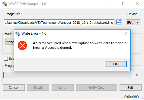

I am downloading the current version, Version 2019_20.1.1, of Tournament Manager for raspberry pi. The file downloaded without a hitch, as did the disk imager for Windows. I’m having issues when trying to get the pi image file loaded onto the microSD card. I keep getting an error stating the following. I’m trying to set up remote displays for IQ tournaments. Can anyone help?

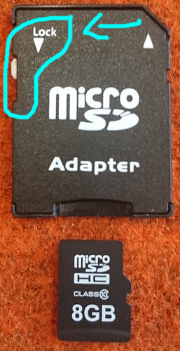

Sometimes microSD card adapterss have a physical switch that turns it onto ‘Read-only’ mode. That could be the reason:
I actually switched disk imaging software to https://www.balena.io/etcher/ and it worked perfectly.
