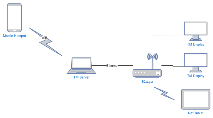

Fast forward to now. Will attempt to run an event in a school gym. Asked for network access and/or guest WiFi answer was no. Will bring an old 5GHz WiFi router and create a closed network for TM, as it is customary. Have a work laptop with a sim card that can connect to the internet via LTE. Reception in the gym is abysmal (one bar or so, in and out). Is bridging the cellular network with the wired an acceptable solution to upload scores to RobotEvents or there are other tech issues I’m not considering? Worse case, can we create a hotspot on a phone, place it in a corner with somewhat acceptable reception and connect the laptop’s WiFi to it then bridge so TM sees internet and upload scores? Is that something that can work? Is there a way to test connectivity to RobotEvents from TM without actually running a live tournament?

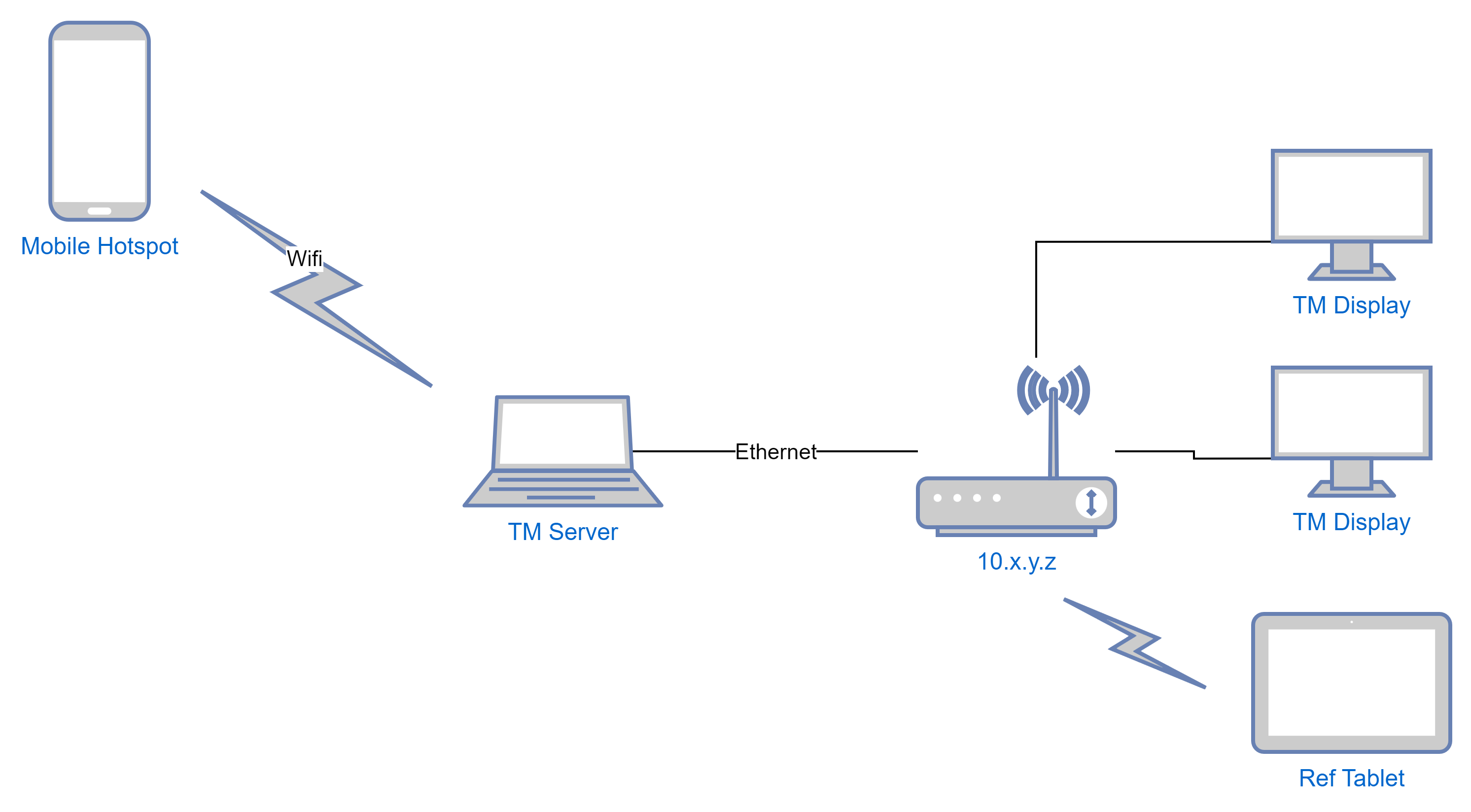

Basically, only the computer running the TM server needs to have internet access. Below is a quick picture of what should work. Use a wireless router to create a private network (10.x.y.z in the diagram). Configure the wireless router to NOT have a default route, and don’t plug anything into the “internet” port on it. Use ethernet from the TM Server laptop to the router and to any wired displays or field controls. You can also optionally use wifi for referee tablets.
Then, set up a wifi hotspot (using a different SSID than the TM network) and have your laptop join it. That should provide internet access to the TM Server to upload things, and the rest of the network stays isolated and doesn’t need internet.
There aren’t any test events, however if you go through the TM wizard and type in the SKU and TM code and if TM can automatically download the event details and team list, then everything should be fine. That uses the same network connections as uploading results would.
