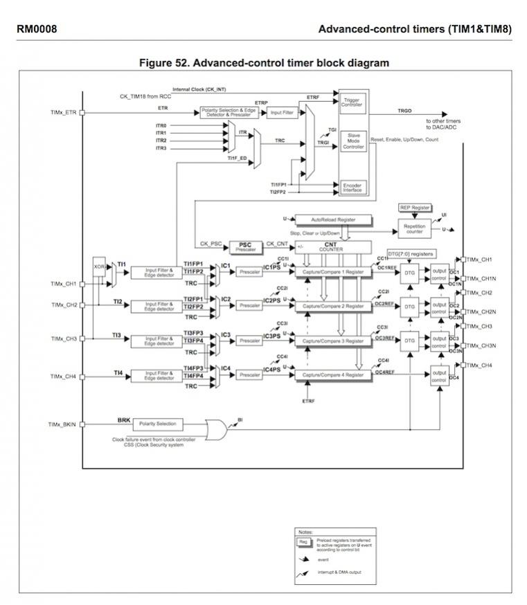

Hey, I’ve worked with microcontrollers and I’ve never felt complete without TMR0, does anyone know if that feature is on the Cortex? If it is, could somebody help me a bit as to how it works?
That sounds like a PIC hardware timer.
ROBOTC has “user” timers available, for example;
x = time1[T1];
If you really want to go “bare metal” then the equivelent for the STM32F103 processor would probably be TIM1 or TIM8. So was this really a serious question?

The reference manual for the STM32F103 is here.
http://www.st.com/web/en/resource/technical/document/reference_manual/CD00171190.pdf
Hm, I’m not that professional as you seem yet:) TMR0 is a internal clock, I’ve mostly used it in the PIC 16F887 to measure seconds.
Does the
x = time1[T1];
do enything like that?
Thanks for helping out:D
Besides timers, there are variables being kept track of in robot C regarding time elapsed.
http://www.robotc.net/wiki/VEX2_Functions_Timing
You have choice of setting timers, waiting for some milliseconds, or looking at program or system time variables.
I am unsure of how often Robot C really and truly updates the variables. But milliseconds is the lowest level of time you can currently get access to in Robot C.
