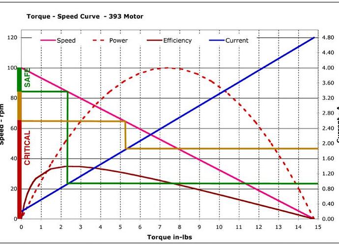

Lets review the torque-speed graph that I’ve been on my soap box about all summer.
[ATTACH]6867[/ATTACH]
I added some reference lines on this version. The green line corresponds to the safe current at which the 393 PTC should not trip, follow this line across to the blue torque-current line and then up to find the speed of the motor, around 85 rpm. The orange line shows the 1.8A point at which the PTC will trip after a few seconds, this corresponds to a speed of about 65 rpm. What this graph shows is that motor speed is everything, if you send full power to the motor and it runs slower than 65 rpm then you are operating in the critical area and the PTC is guaranteed to trip.
The cortex is seeing the sum of the current going to all motors connected to a protected bank, two motors running within the safe zone should not exceed the 4A (or perhaps slightly less) limit for the PTC. My little pushbot only draws about 0.5A per motor when running so can easily run from one cortex bank.
