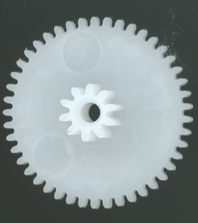

well vex doesn’t have a 256t gear, ig you could use compound. but im wondering why do you need this gear ratio?
I’m trying to understand the theory. if one were to use compound gears then you could step up RPM with identical gears at each stage , correct?
Correct. because the small gear spins at the same RP as the large gear it shares a shaft with. and then you can drive another big gear with that small gear reducing the ratio again and so on and so forth. heres a decent article explaing and showing some examples
https://woodgears.ca/gear/ratio.html
In my scenario, i’m going in the other direction - Driving the small gears with large gears.
