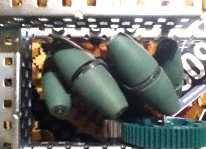

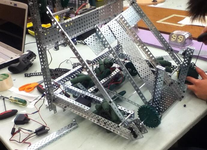

I would like to know does 4 393-motors powering on each Mecanum wheels (in H-Drive) with 4:1 gear ratio each wheel creates too less torque when moving the robot forward on the competition field. The Arm of the Robot is designed to be light-weight, Please view the photos.
Our robot first couldn’t travel more than around a meter on the mats, and later on it couldn’t even move from resting(on mats.). When we first test the base on the ground, the robot can travel better in forward and backward then sliding left and right, but then it became the other way around the second day.
There is also two another interesting problems, where the two back wheels couldn’t spin continuously(to right only) when the robot is lifted in the air and these two wheels are powerful enough to rotate the robot to left but hardly to right.
What was going on?

A ratio of 4:1 for speed is far too high for a drive train. I would suggest directly driving your mecanum wheels with your high strength motors in a 1:1 ratio, the speed setting is fine. Additionally you seem to be using your mecanums in the wrong configuration. Mecanums allow all wheels to face the same direction like in a normal tank drive but gives holonomic capabilities due to the angle of the rollers on the wheels. Take care to have the right roller directions on the right corners of the robot.
The mecanum rollers should form an X when viewed from above and form an O when viewed from the bottom.

in the pictures, its is at 5:1 o.0
do what mochi suggested, that way, your robot will be able to move
Your wheel configuration is interesting but I’m not sure if it’s the best. As for the torque, it sounds like you are hitting the circuit breakers in your microcontroller due to drawing too much current from your drive motors. On a 4:1 ratio, your drive just doesn’t have the torque necessary to move your robot unless it was an extremely light robot (say under 5 pounds or something). I’m not sure exactly how the math works out, maybe more experienced members or mentors can comment on that, but from experience most teams run 1:1 ratios on their drive and vary depending on their design/strategy between internal speed gears or internal torque gears.
So even when the circuit breakers triggered even the wheels are spinning in air? If so, What is the solution?
Looks like it’s 5:1, haven’t count the teeth yet.
Just looking at the wheels in the back - do you want them swapped direction wise? I can’t say for sure not playing with this configuration.
I think the natural driving forces would want to push outward on those wheels in opposite directions versus inward like the front wheels. The forces on mecanums should go along the 45 degree angle. Those forces should still cancel each other out.
Also, would the overall center of rotation be OK in your configuration? Left/right of the front and left/right/back sets should neutralize each other but front set combined with back set may not be ideal.
My drawing is crude but the normal way is to make a square with the wheels oriented all parallel to each other in a square and not in an H. As you get to the center of rotation the torques should cancel too.
However it may be more about the center of rotiation and you have torque fighting you. If you then try and find the real center of rotation on your configuration, you might see it’s not as neutral as you think. (you may need to get a kinematics book out here) Rotational forces may need to be taken into account as you translate the forces about. You need to apply the torque effects too for the angle off the axis. You might be making some forces that fight each other in your configuration when used as a whole which is only hurting you more. The front back center of rotation may be behind the horizontal wheels. So it may just be a matter of placement of the H wheels to get it really neutral.
You can eyeball neutral by following the 45 degree out of the mechanum center and see where they all intersect. Or I may be totally off base. Maybe you’re already there and you’re just over gearing it.
The reason your robot is not functioning correctly is not weight distribution. The problem is that your gear ratio is too fast for the weight of your robot, and the torque of your motor configuration. Adding more motors to your drive could help, but as a rough estimate, I would say it would take all 10 of your motors on your drive with a very light robot (drivetrain only and made out of aluminum) to be able to get your 1:5 gear ratio running on the mechanum wheels.
In short, a 1:5 ratio on your drive with mechanum wheels is just not going to work on a typical VEX competition robot, especially one that is made out of steel. I suggest changing this ratio to a 3:5, changing your 12-tooth metal gears on the wheels to 36-tooth plastic gears.

Since the front wheels are not programmed to spin when the robot is turning/swiping (sorry I didn’t address that at first), the four wheels don’t necessary have to be neutralized.
The robot is designed to swipe when rotate; The pivot is at the front instead of at the center for reducing the risk of the robot swiping away the objects during the intake since the intake system is at the front of the robot. The rotating of the robot is fine, but in one direction only (eg. able to swipe left but too week to swipe right) which is wired. So the torque is large enough during the spinning/swiping, what about why the robot can only spin/swipe in one direction?

I don’t know how to figure it out mathematically, but I know from experience that you will never have enough torque on 4 393 motors to drive a competition robot at a 5:1 ratio. The highest I have ever tried is 2:1, and even that faced issues of a lack of torque leading to overheating sometimes. On a 5:1 ratio, assuming the motors span at 100rpm, if the motors had enough torque the robot would travel ~150 metres (~170 feet) in a minute. That is far more speed than is necessary or possible in a competition robot. The only feasible solution to your problem is to change the drive to a more reasonable ratio like 1:1, 1.4:1, 1.6:1 or maybe 2:1.

Yes, Red means the torque requirements are too high. It can be determined experimentally with the lightest possible robot consisting of just battery, cortex, motors, wheels, and minimal frame. If the red was defined by a squarebot with only one motor per side, maybe the boundary zone will work with more motors. 5:1 speedup is just crazy though, as your evidence shows. Also remember that the speed chart is defined for simple wheels pointing in same direction. Omni/holo/mechanum drive require more torque.
