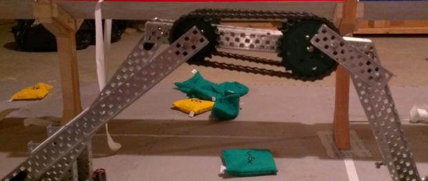

As far as lift systems I intend to use a combo bar linkage system which has a 4 bar that mounts to the chassis and a 3 bar and chain that attaches to the intake. It has a 46" vertical reach, and works great in CAD land, but in the real world it does this (attached) as it lifts.
What is that? We get withdrawals after about 3 day’s and end up doing things like hacking my wife’s Roomba. The entire drive from the world championships back to Texas was a brainstorming session followed by weeks of drawing, CADing, and pages of math. We skip a day here and there since Bryson is doing some online summer classes and have an occasional “Mental Health” day here and there. It’s nice to try and finish early so you can at least realize you had a bad idea and start over if nothing else.
