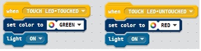

Touch LED works strangely if it is touched before program running
Case1:
 Before running: Touch LED status(Untouched)
 Program Running: (1)Touching Touch LED: LED lights on and the color is green
(2) Untouch Touche LED: LED color turns red
Case2:
 Before running: Touch LED status(touched)
 Program Running:
(1)Untouch Touch LED: LED light keeps off instead of light on with Red color
(2)Continue touch and untouched Touch LED: In the first few seconds, Touch LED doesn’t work; after a few seconds, Touch LED works but it takes more strength (becomes insensitive ). But if we touch it with another part of our body (opisthenar for example) after taking the finger off, Touch LED works immediately without any delay. Besides that, we can make it with little strength.1

unfortunately what @Foster describes is not entirely correct. The touch led does not send the touch information via the i2c bus, so there is nothing to queue, it actually uses a digital IO connection to communicate that, only color information is sent to the sensor. I’ll have a quick look tomorrow and see if I see that behavior in VEXcode, it may just be a bug in Modkit. The touch led is a capacitive sensor, check that it is working correctly by opening the devices screen on the IQ and using the diagnostics there.
I had a look into this and what you are experiencing is expected behavior.
When a program runs the sensor is reset (full disclosure, this does not happen in robotc due to how robotc works). When the touchled is reset it needs to measure a baseline for the capacitive touch sensor, if you are touching the sensor when it is reset then this “touch” value becomes the base line, that means that further touches will be mostly ignored.
the bottom line here is don’t touch the sensor when launching the program.
