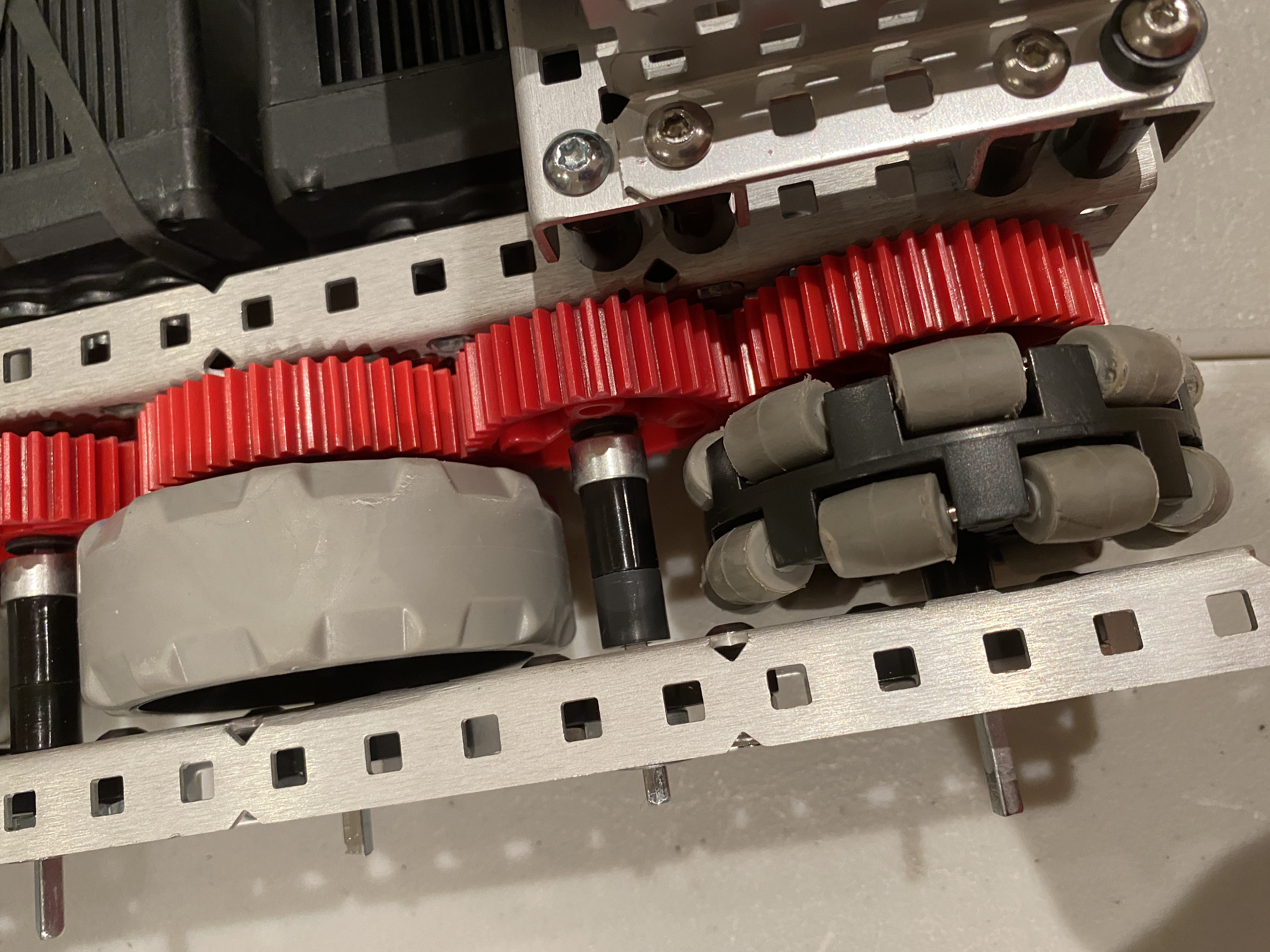

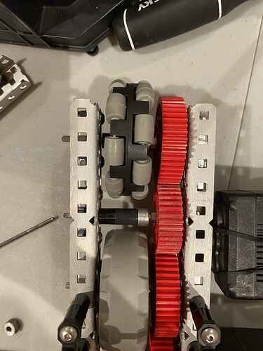

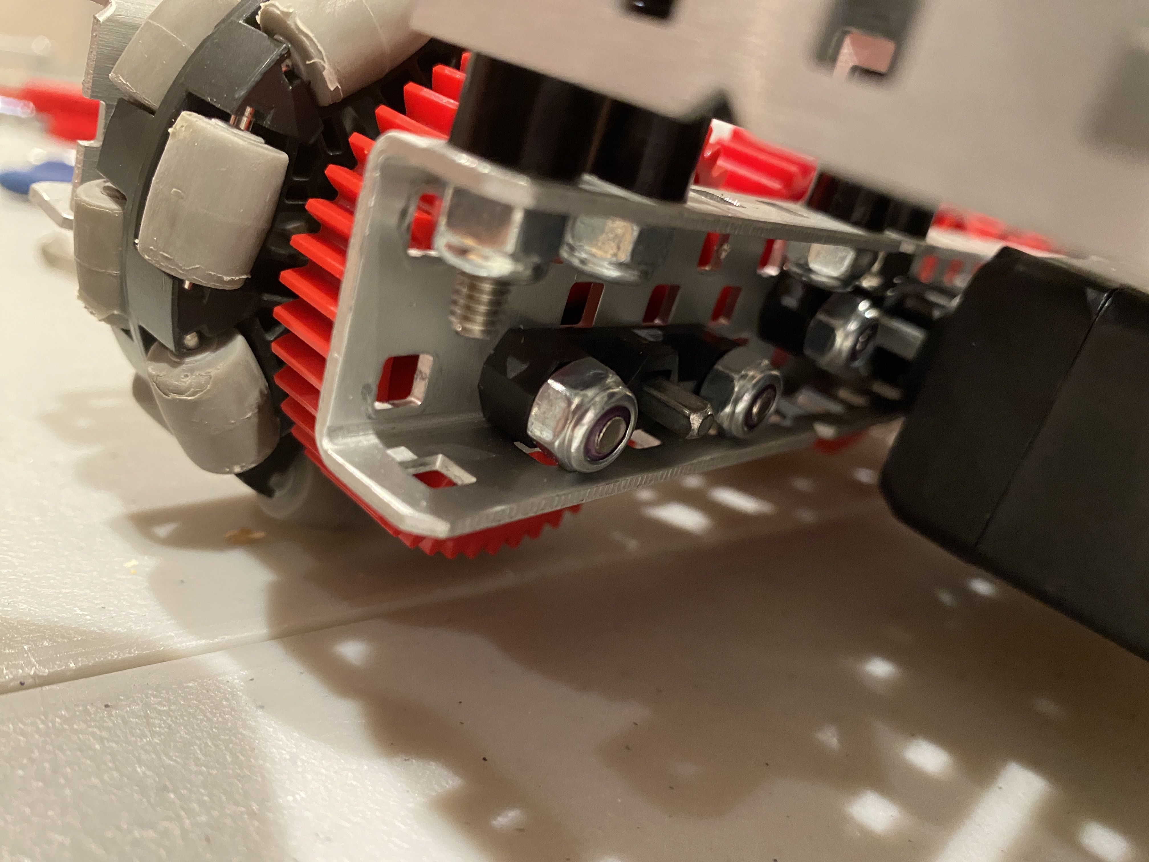

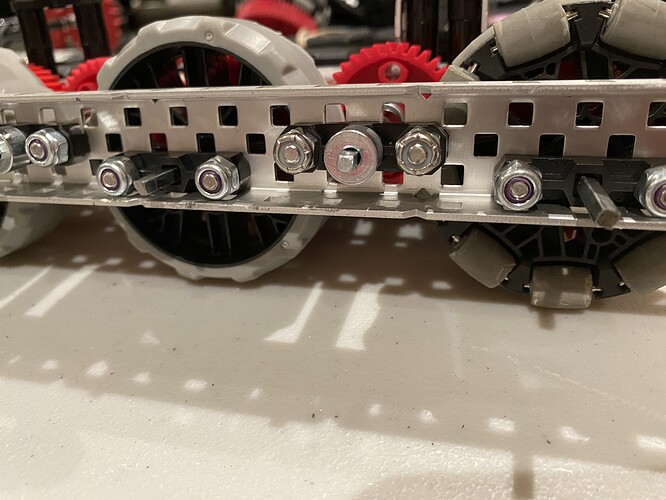

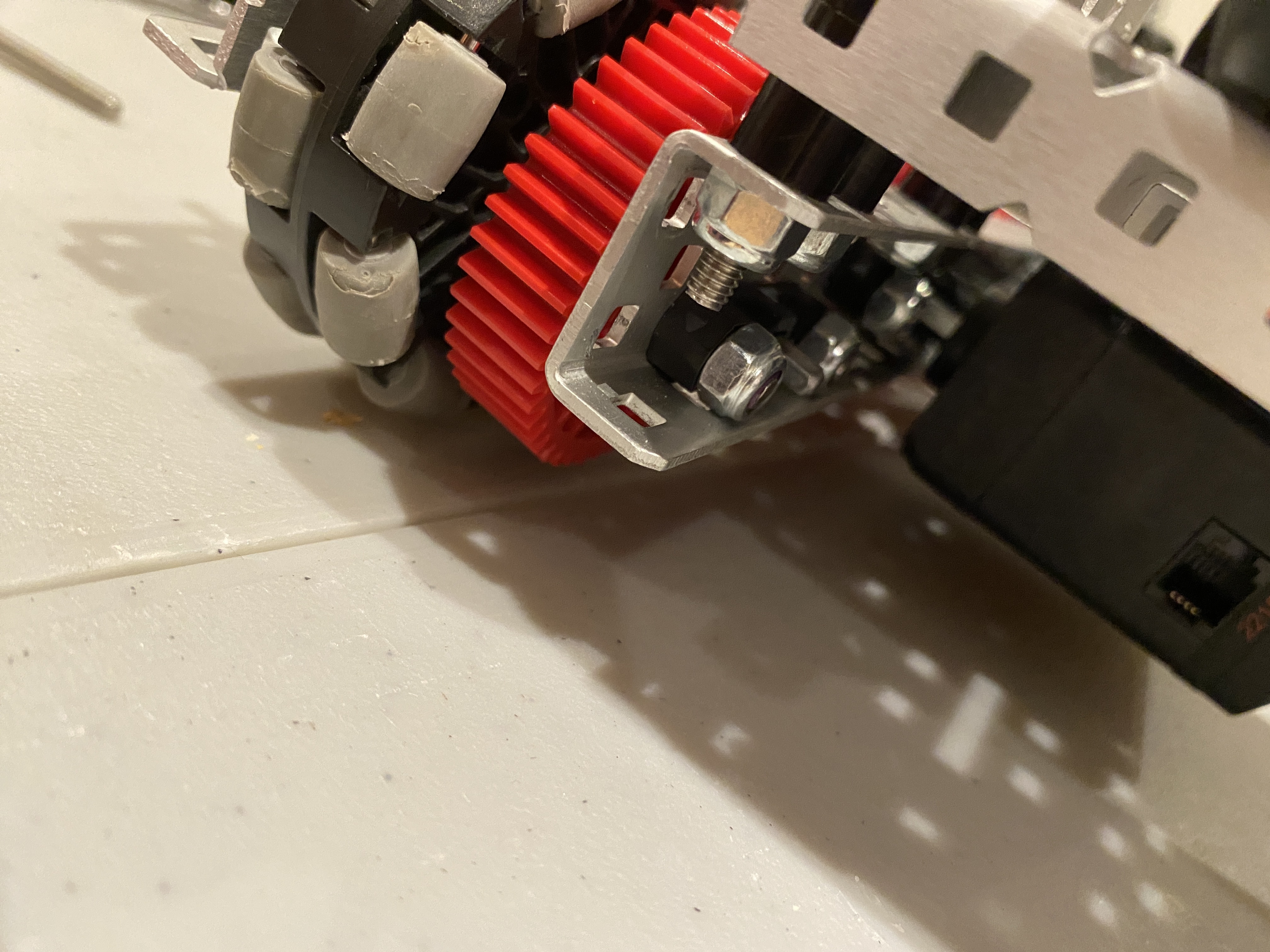

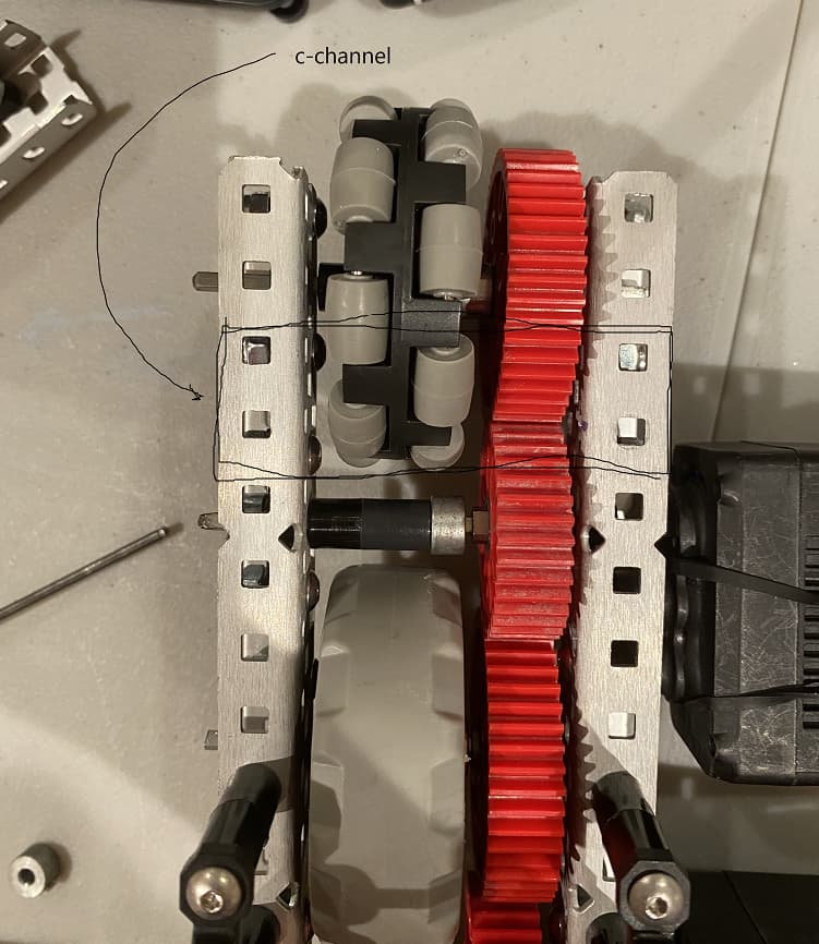

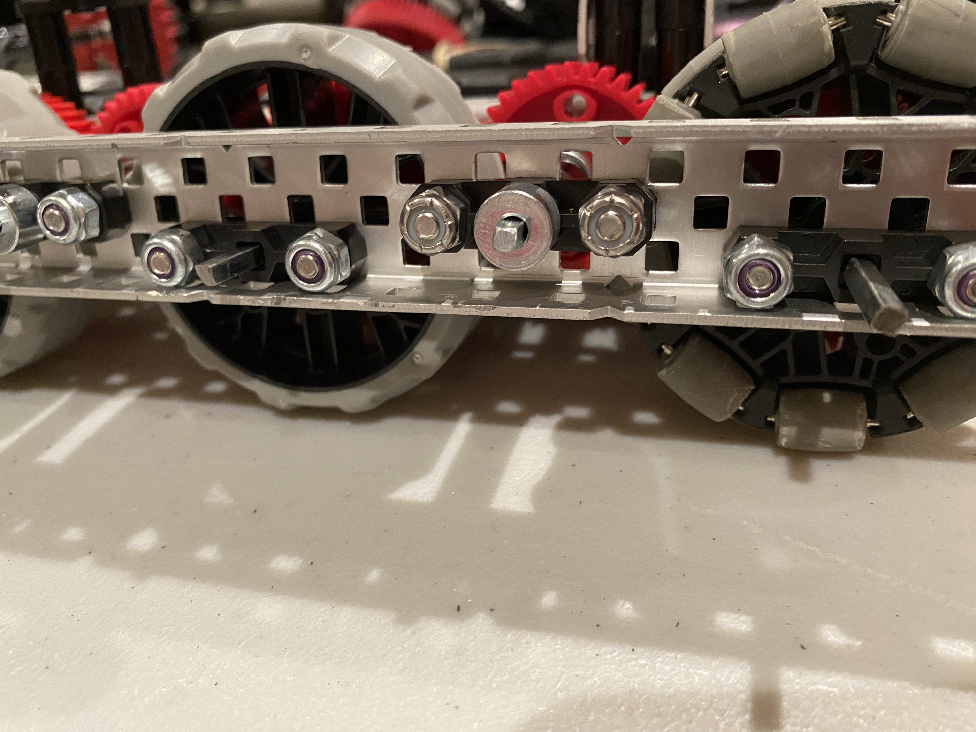

Here are a few photos of our drive, the photos our slightly outdated but in the current version we have collars in between the c channel and motor. Those are the collars that are very hard to get to.

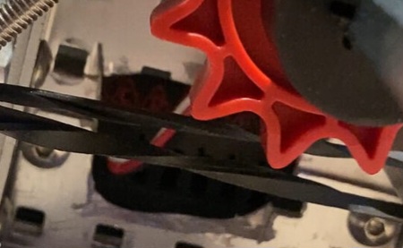

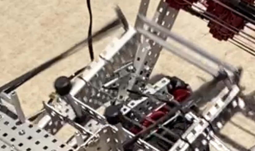

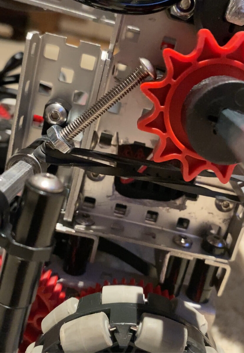

Here are photos of the ratchet and banding on the catapult. Thank you guys, and sorry for the late reply!
If you put two shaft collars in the middle, it will work just fine. That should make it easier to reach the shaft collars.

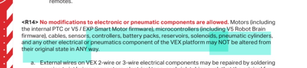

Isn’t this illegal under rule R14?

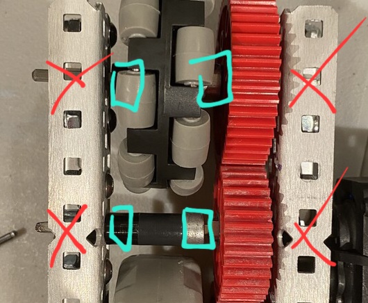

For your drivetrain issue,
b9a7431b0135ff61629599717133294ef7ca3475_2_750x1000
Put shaft collars where the green boxes are. Do not put shaft collars where the red "X"s are, as those are very inaccessible.
As for your ratchet, I would use a regular high strength gear, not a sprocket.

If it is, then you could just use a nylock nut or a shaft collar

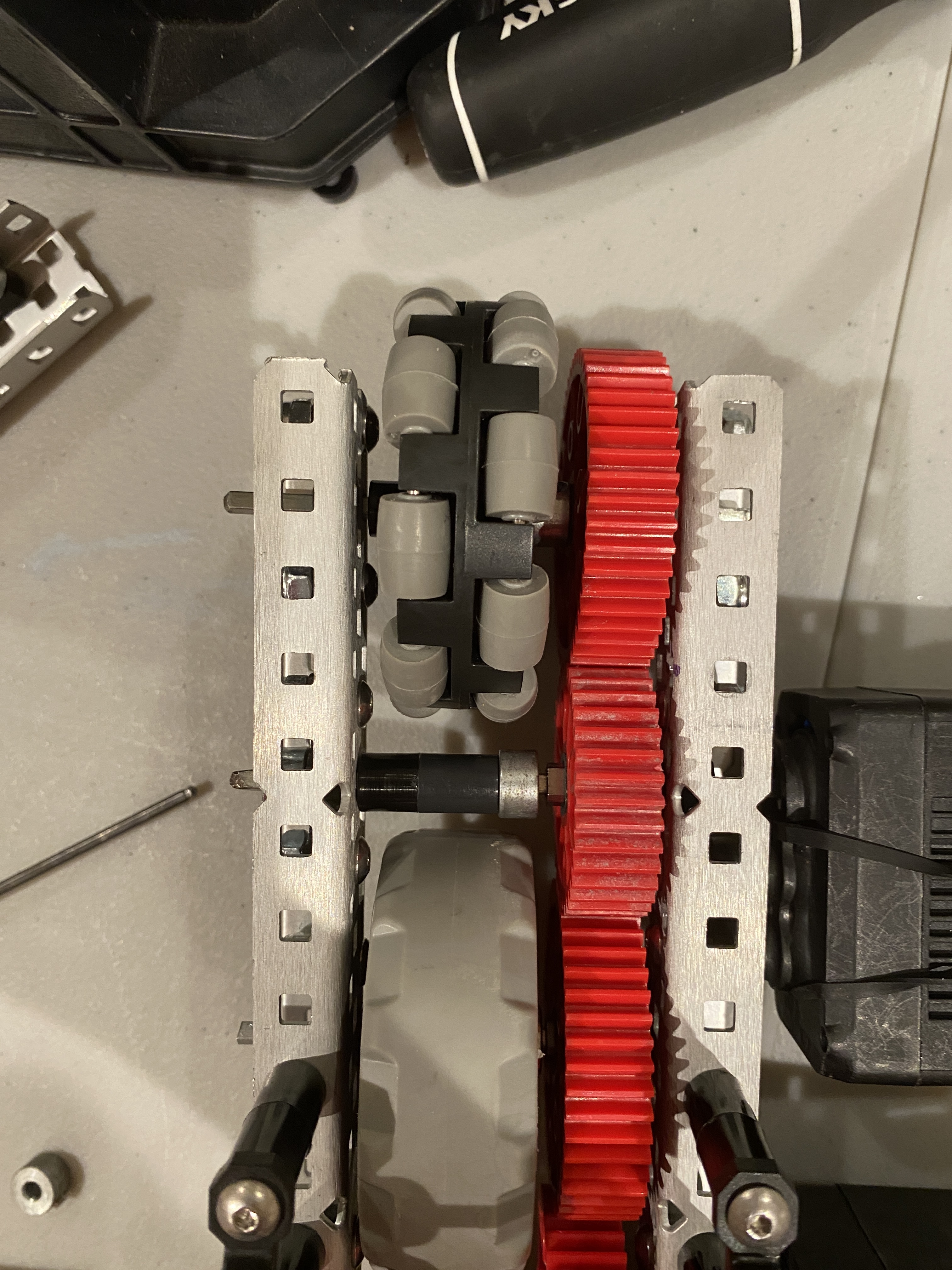

If we were to put the shaft collars on the inside of the drivetrain, there would be no way to keep the outside c channel in place. I originally had this design, but struggled with a way to keep the channel in place.
The reason we had to dremel of a hole for pneumatics is due to the very tight spacing from our catapult. It wasn’t the most elegant fix, but we had about 2 days to add in pneumatics and I didn’t want to take apart the drivetrain and cata just to add more space to the brain.
I tried this but for some reason the screws on the pistons are a different size on the usual allen and star screws. Maybe the VEX V5 pneumatics kit fixed this, but I only had access to a few SMC pistons and reservoirs, and whatever connectors and electronics I could find from either SMC or VEX.

Could you possibly send a picture so that we can see this tightly spaced drive? This is one of the cases where a picture is worth 1000 words.
For this, I really do just think you need to tighten these more. Just grab a wrench and maybe some pliers and get to work.
What type of rubber bands are you using? Are any of them fraying? How much tension are you putting them under?

This is a serious issue, your drivetrain should not be held together by your shaft collars on an axle

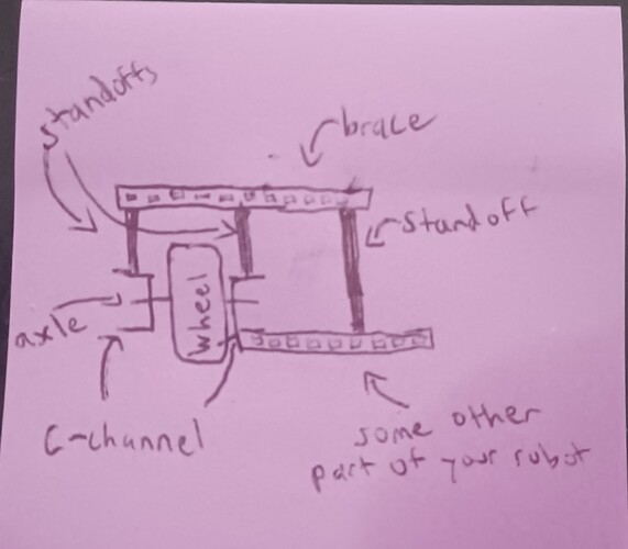

I’m going to pop my head into this topic to clarify something. You need to attach the outside c-channel to the rest of the robot frame using a crossbar. These are pieces of metal that hold the outside c-channels and the inside c-channels together.
Do not just let that channel sit on the shafts.
That’s a good idea, however due to the intake and catapult being situated at the front and back respectively, the only places to add crossbars are in the middle, which isn’t optimal. And due to the nature of the spacing in between the channels, the holes would not line up for a crossbar. Writing this now I realize that I should probably adjust the spacing, so do you think it’s better to try and cut down on spacing to go for five holes, or add a little to make it 6?
Also, is having a crossbar in the middle as effective as having two on either end? It would seem not, but I don’t have a lot of VRC experience, so I can’t say for sure. Our robot is not present currently, but I will be able to test more things tomorrow. (hopefully) Thanks everyone for your input! I will move the collars inside the drivetrain.

This year was my first year building a competition bot, and I did this. The c-channels ended up flexing outwards like this / \ and created a lot of friction. It also led to gear mesh problems.
Use standoffs and some c-channels to brace your drivetrain
It’s better to have the crossbar at the ends, but if you can’t have one at both ends, then one in the middle and one on either ends is fine. But if you can’t have a crossbar at either end, then put a crossbar in the middle and connect the outside c-channels with a standoff or a c-channel to stop it from flexing outwards and creating friction.
I would recommend 6 because In my 2 years of VRC I’ve never seen anyone fit everything in 5. It might be doable, but it’ll probably just cause more friction and other problems.
I mean, I could try and switch it to LS gears. I don’t know if they make them in 36 and 48T but I could always just use a hacksaw. I’ll be sure to add some bracing on our next bot.
Oh yeah, I forgot LS gears existed…
