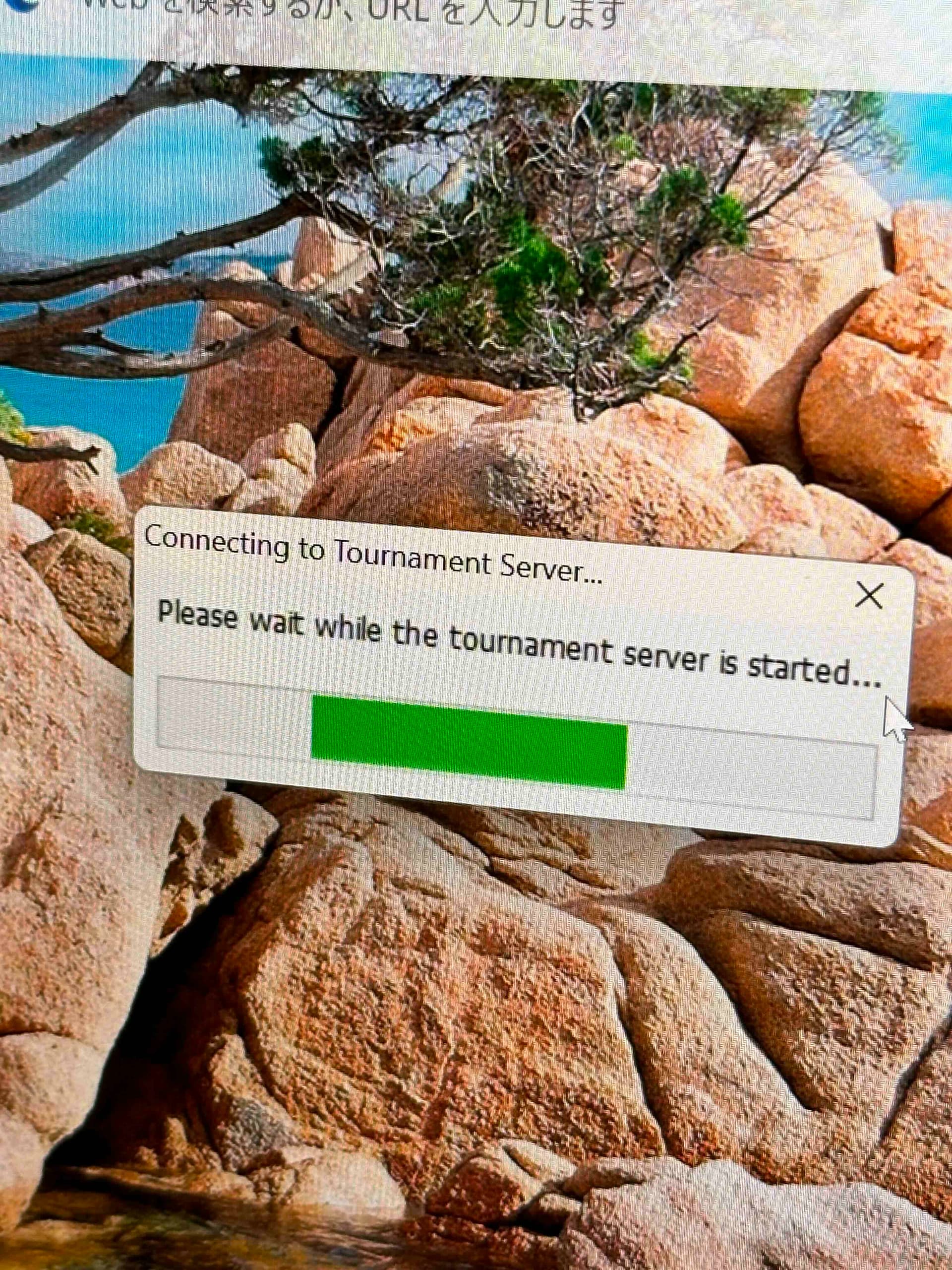

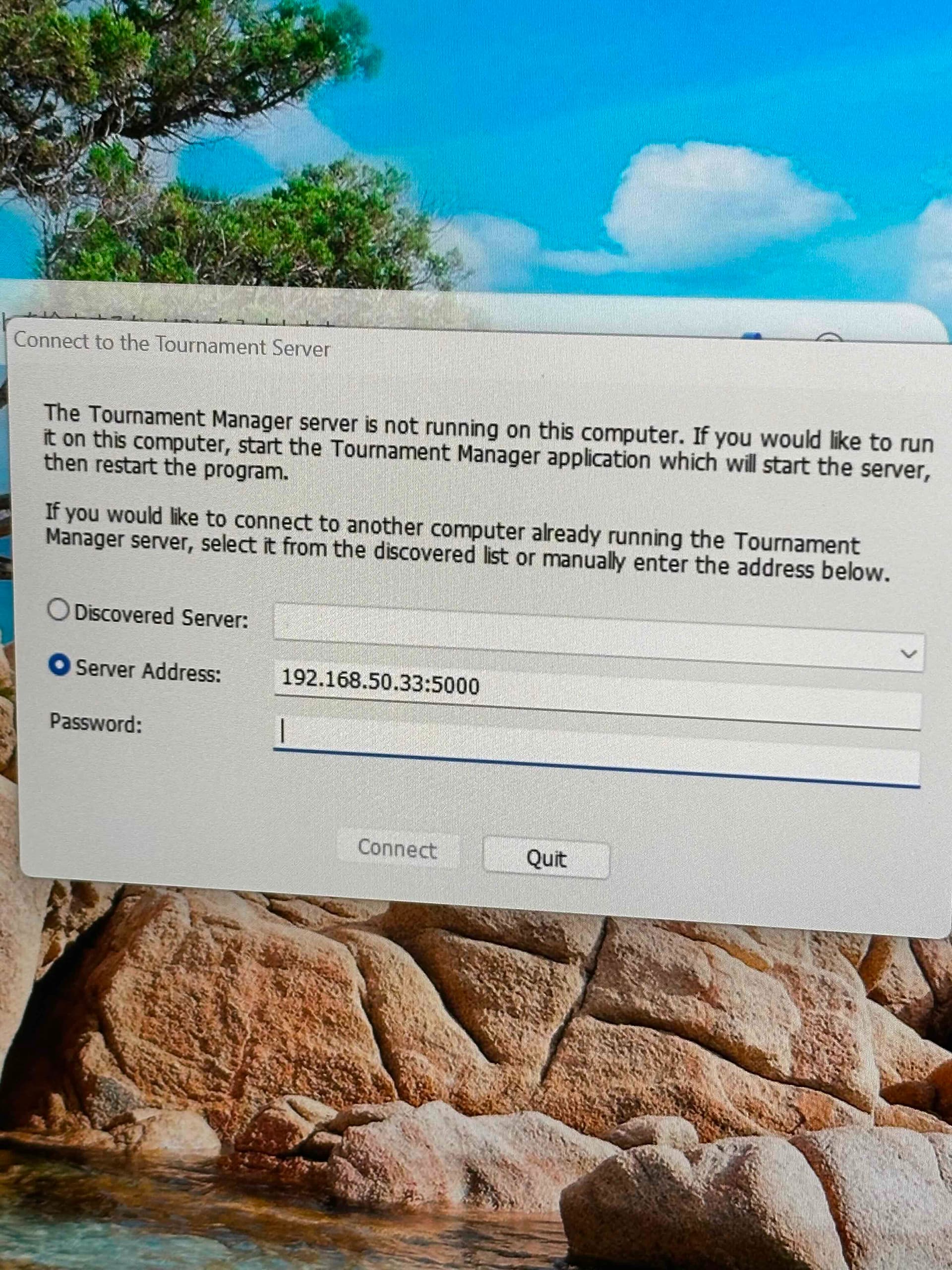

When I try to open the Tournament Manager, I end up in the Remote Connections screen. I have rebooted and reinstalled and it is the same. Can anyone help me with a solution?
Attached is the situation.

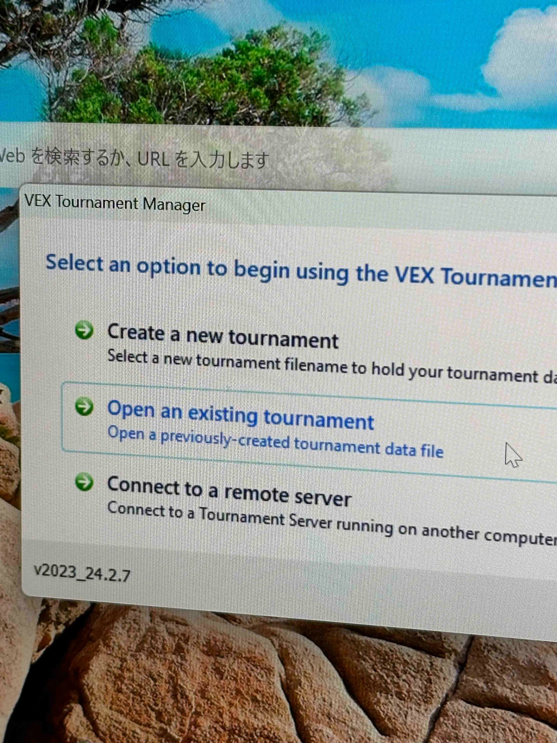

TM Version 2023_24.2.7

Assuming you not selecting the “Connect to a remote server” button, deleting the file at C:\Users\<username>\AppData\Local\VEX Tournament Manager\appconfig.db will reset the config file. TM will generate it again at relaunch. This file normally does not get deleted when uninstalling which is why some bugs with TM can persist. In the future, if issues persist after uninstall, you can use tools like Revo Uninstaller to completely remove all program files and registry entries.
