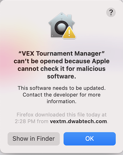

Its giving me this when I try to open tournament manager. Any thoughts on what I should do?
Has anyone else gotten this issue for TM on mac?
If you’re running Big Sur or later, TM won’t run:
On Catalina or earlier it should run fine – right-click the file and select ‘open’ rather than just double clicking it.
In Catalina if the pop-up window doesn’t give you an option to open it, you can usually run it by going into the Privacy section of System Preferences and clicking ‘Open Anyway’.
Same issue with me don’t worry, use windows it will atleast cover that for sometime.
