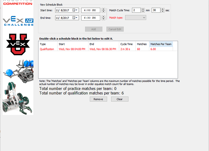

Is there a way to select just the number of matches you want each team to have instead of having to enter time/date and cycle time to get what you want?
20 teams with matches from 4:00 to 6:30 with a 2:30 cycle will give you 6 matches per team (see attached image). Maybe the numbers you thought you were inputting weren’t correct?
If you do it under scrimmage you just select the number of matches.
