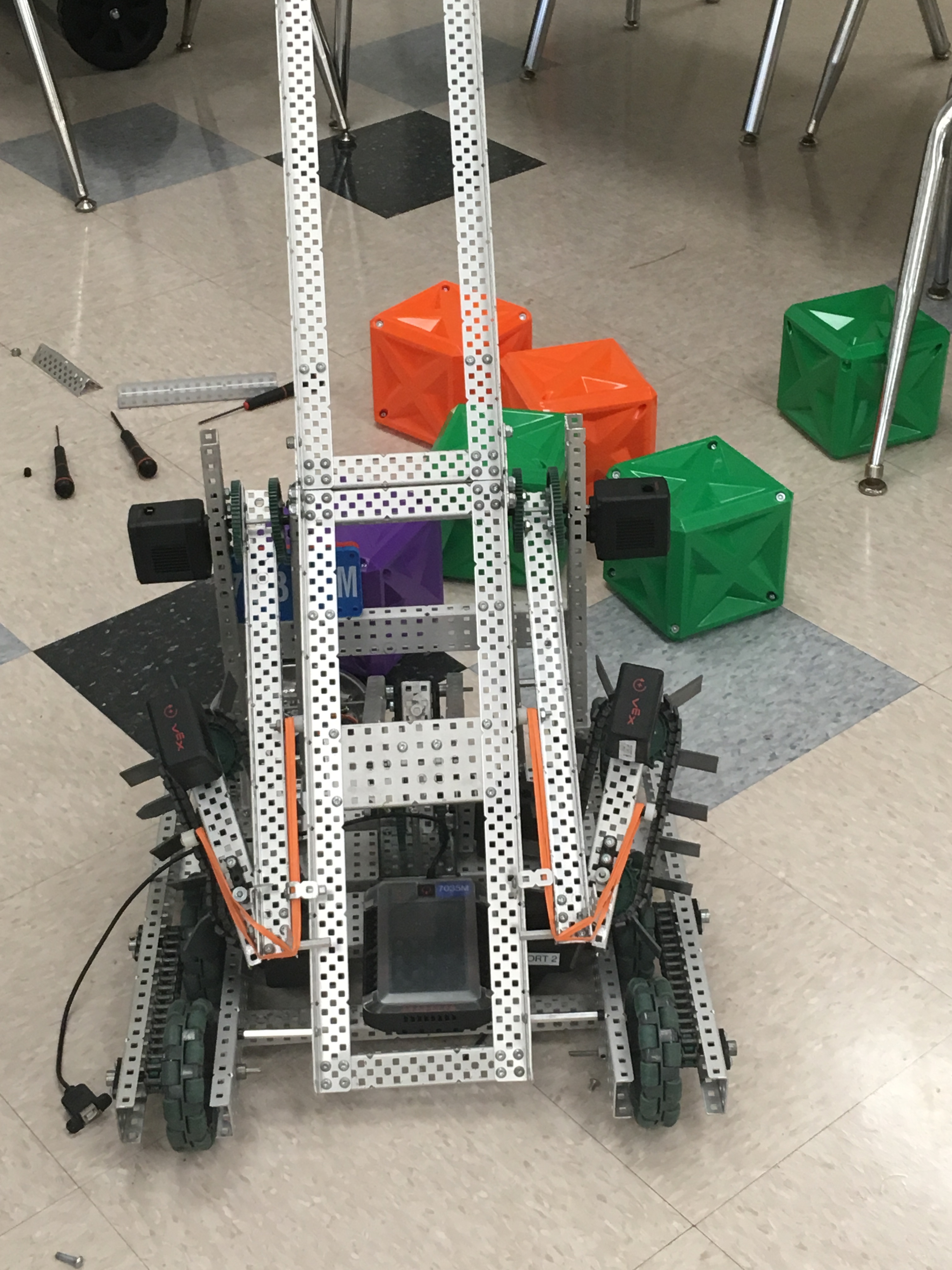

Hey. Ok so my team has towers on our robot that have the intake arms attached. We were wondering if it would be smarter to attach one torque motor and a high strength axel or two torque motors on both sides with a regular axel.

Definitely one torque with an HS axel.
well that depends. if you can get away with only using one motor that could be the better option, as you save a motor for use elsewhere. but then again if you don’t have any other use for that second motor it could be a worthy home for it.

Just some advice, if you do one motor and a hs axle you will need to brace the two sides of your arms very well. If you don’t one side will go up at a different rate and there will be major discrepancies in the position of your arms. P.S. if you think you have braced it enough, than you haven’t.
@Cadaver_42 Thank you. But how do you mean by bracing the arms more? I’m a bit confused.
Here is the picture of what we used to have. The two motors on the top are for the towers. We r planning to just have the one motor tho
using a 4m drive might be a better investment of that extra motor tbh, but Its really up to you, 2m can be acceptable.
another thing I’d add is you should maybe move those motors to the inside of your lift towers, or have something protected them, you wouldn’t want to snap off those motors (did this in itz, not fun)

@Xenon27 thank you! I’ll suggest to my team bout putting the motor on the inside. Now that our lift is moved further up I think putting the motor inside may be better. Thanks again

You will want cross bracing between the arms. this can be done with stand offs, c channels, and I have seen it done with one by’s but I’m not sure how well that works. X shaped braces work well but if you don’t have the room for that you can just brace straight across. Another thing you can do if you have space is connect the gears driving the arms with stand offs. This will help the arms move at the same time with the most torque.

What we did (don’t do this, put a high strength axle through the towers, but we don’t have the towers connected together except for the cross bracing in the arms. We have one motor on one side, and rubber banding on the other. We used linear sliders for the crossbrasing --which worked quite well. I don’t recommend using standoffs as cross bracing because they are hard to attach (at least for our robot). Don’t waste another motor on the arm, it is just not necessary. Like @Sylvie said, use a 4m drive, 1m arm, and 1m tilter. Speaking about your arms, I would recommend them flipping down from the top. Our team had compression issues with our intake, and then we solved them from having a vertical pivot point (it might seem unnecessary, our team thought it wasn’t until we switched, and it works like a thousand times better). I would recommend making your base thinner length wise because it looks like you have like a 16 inch base (I could be wrong). Our team didn’t consider this factor when designing our robot, and now it is ten times harder than it should be to stack two towers in the big zone. I guess these are all my tips, and I hope this helps your team.
