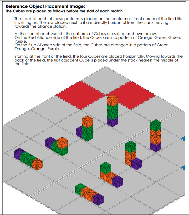

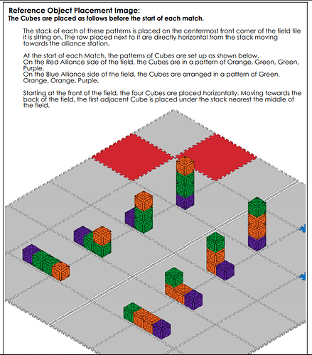

I have been looking at the Tower Takeover Field from different games in Detail and I have realized that their doesn’t seem to be much of a pattern or rules of placement of the cubes at the beginning of the game. The only reoccurring trait would be that the outer tiles tend to have no cubes and that the cubes are already stacked closer to the center towers. I was wondering if anyone has found any info on the placement of these cubes or have noticed anything about them. It may seem simple but it could help a lot to know the most likely location of certain cubes and their colours.
The cubes have a very specific starting position - it’s found on just about every page of the document above but this is the best one with the specific rules laid out:
Thanks, I was overthinking it, I initially thought it would be random and looking the games from video clips made them look random, probably just my mind telling me what I wanted to see. Now that I look at it, and looking at the document, I can see the cube starting positions.
