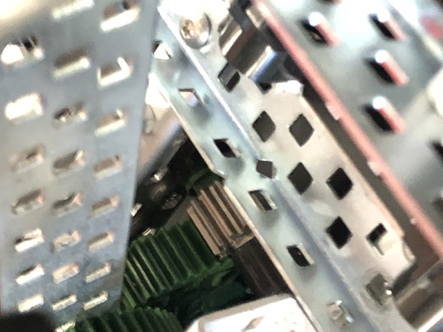

Hey guys, first forum post on this acc but my team and I are kind of in trouble right now. Couldn’t find a better category to post this under either so sorry about that too.
We are currently experiencing a gear slippage issue on our tray pusher system the gear system is compounded but the core of the issue is that the smaller gears and the larger gears aren’t pressed together tight enough causing them to slip. Does anyone know how to work around this issue?image

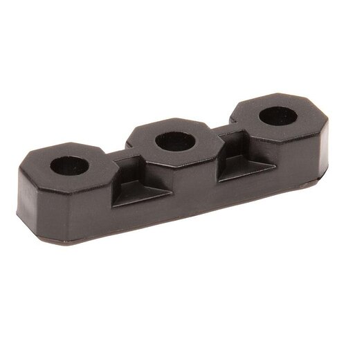

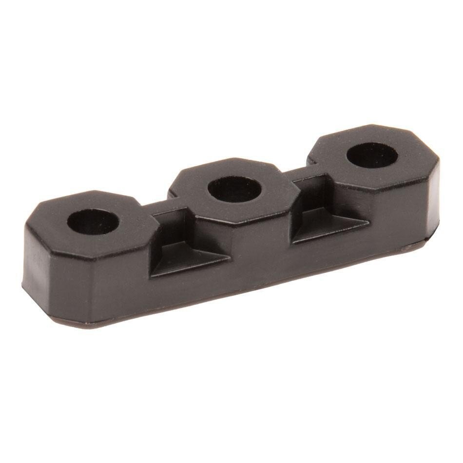

Ah yes we are using these
Additionally, put a 12T on either side of the 60/84T you have. This additional gear will force the green gear back towards the metal gear. If you chain the two 12T, it would eliminate the translational forces from the 12T on the driven gear, decreasing the stress on the driven gear’s bearings/shaft.
