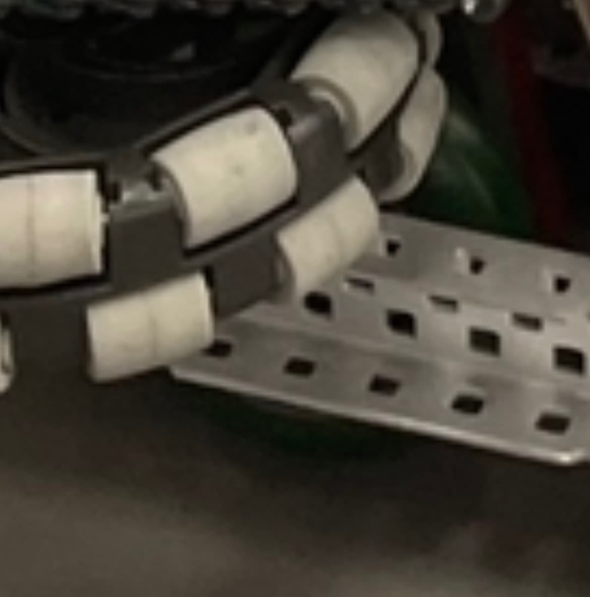

Ohhh, now I understand what you mean. My team actually tried this in Change Up as our smaller Omni wheels had not yet arrived, yet we still wanted to have encoder wheels for a more accurate autonomous.
(You should be able to see them poking through beneath the intake roller).
What we found, is that if you have any slop in the encoder wheel joint at all, the encoder wheel can slip and “spread out”. This can affect your autonomous routines and can prevent your robot from driving properly straight. This actually impaired our robot’s movement during matches and prevented us from doing well in the robot skills challenge. Another issue is if they are not perfectly co-axial with your robot’s center of turning (especially if you already use traction wheels on your robot), your robot’s motion will be impaired (especially turning-wise).
So, to answer your question, I would much rather prefer using Omni wheels on your encoder wheels, and save the tractions for the actual drivetrain (this is why many teams use 6 wheel drivetrains where the middle wheel is a traction wheel). If you don’t want to be pushed from the side, then I would recommend sticking with a 6 wheel drivetrains with middle traction wheels.
