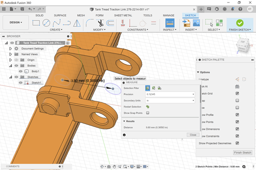

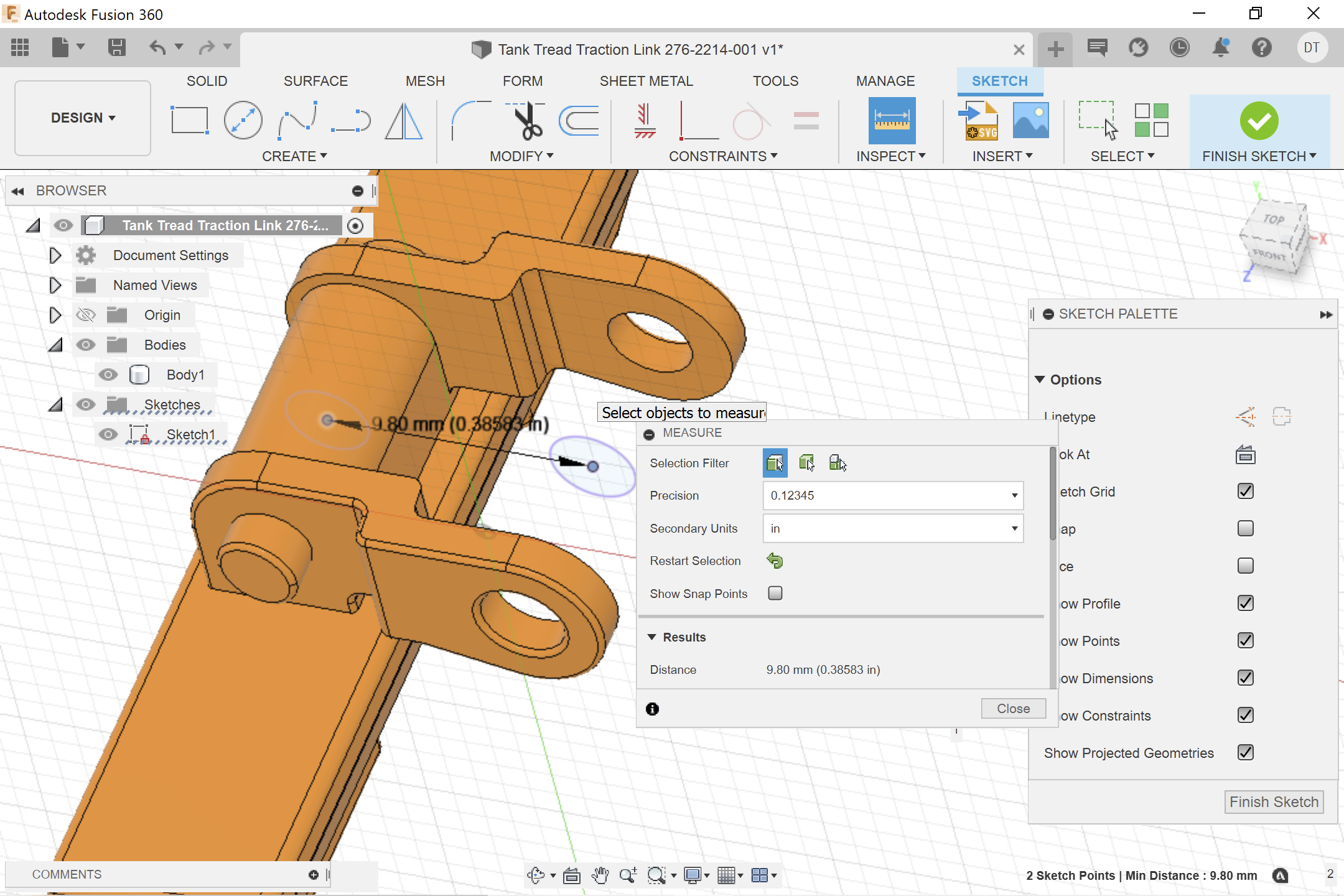

Y’all need CAD. It’s 9.8mm or approx 0.38".
