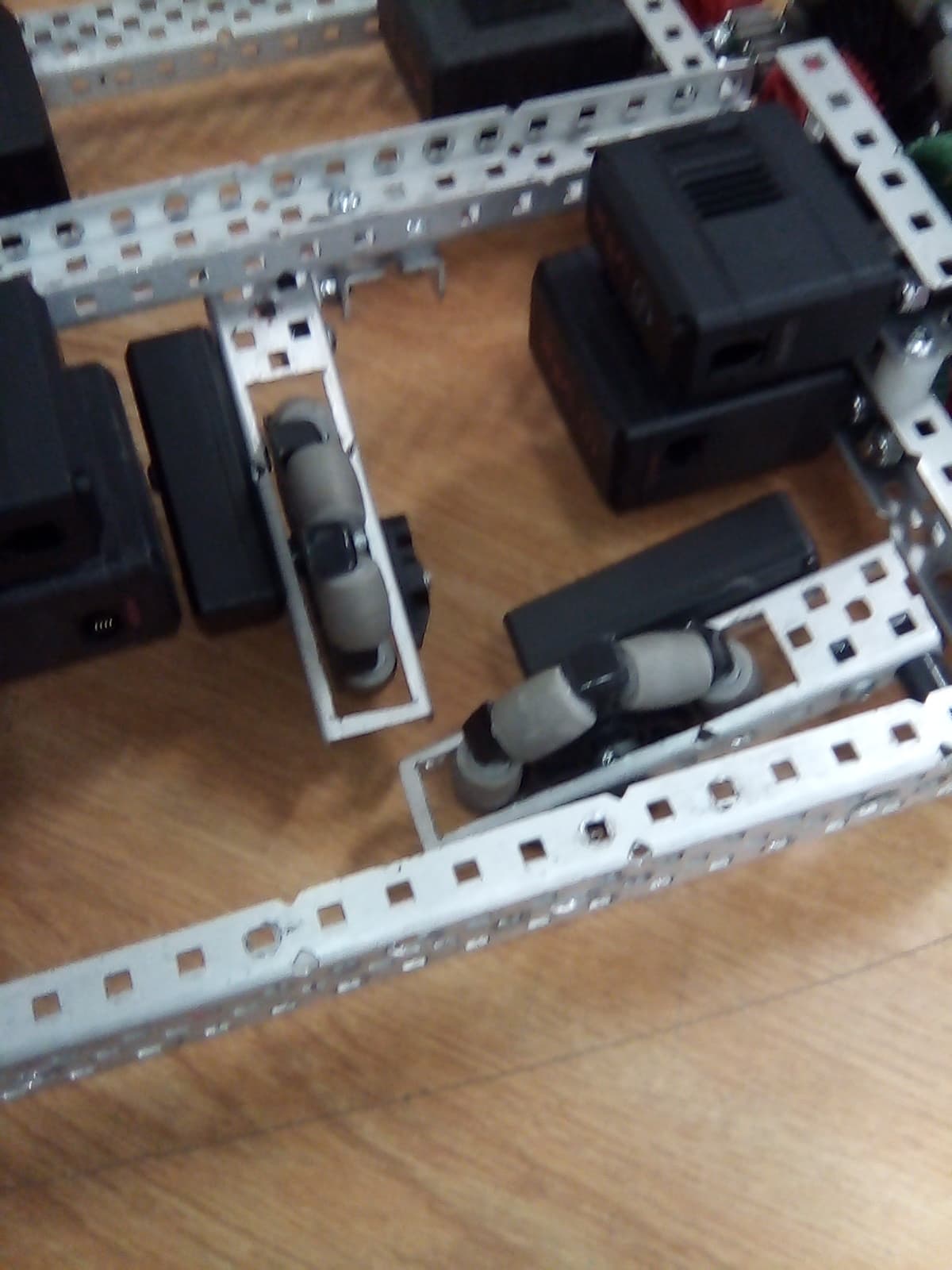

Are people using tracking wheels for odometry this year? And if so how are we making the hubs more compact to compensate for the small bots this year?
My team will dremmel out the inner area of a piece of channel and then put half a 2.75 inch omni wheel inside, with the rotation sensor being mounted to the out side of the c-channel. We also just mount them from one side using a screw-joint, you just have to make sure that whatever the screw joint is mounted to is very sturdy or it could bend causing problems.
This is the best photo I could find of ours.
