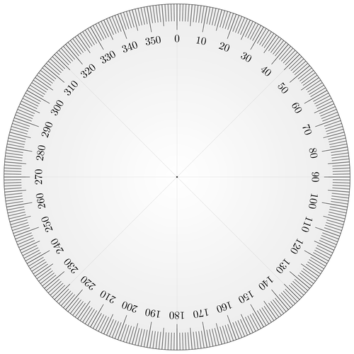

If I need to turn an angle that is not exactly 90 degrees, I usually just look at a degree wheel like this and use it to see where I want the robot to face and use that number.
image_2022-08-03_095433867
