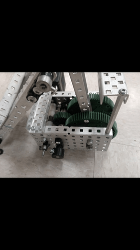

we do a very strong gear ratio but im not sure what the gear ratio is ill send a pic
i think its 1:18 im not sure its too OP but i can go somewhat fast so IDRK
That’s 21:1. If you have a green motor, it’s the equivalent of 10.5:1 which isn’t bad, but with a red it’s pretty slow.
we use a red motor and run it at 90% speed
