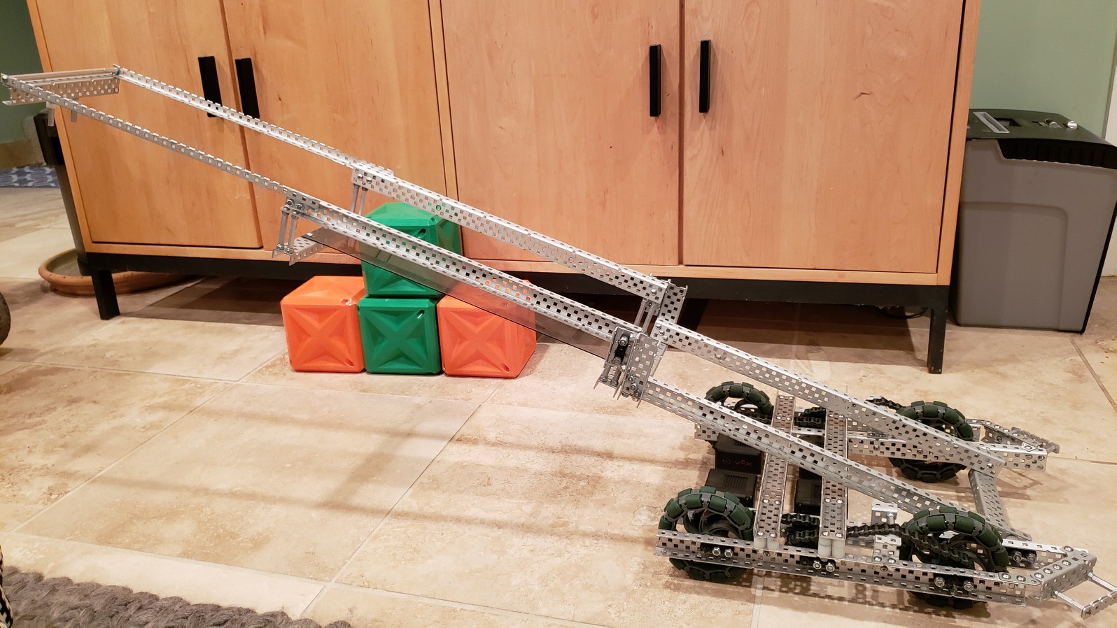

You have the top stage extended up with standoffs, but for the bottom stage, use plates or polycarb to make the walls higher, just inside (or out) of the extended c-channels on the top stage. If you want a third stage, make it a cascade.
I was trying to post a pic but I don’t know how to but It basically has 2 c channels side ways facing out. Then they are attached in a very similar way to the robot goofy. You could look up “vex tower take over goofy” it l’s the documentary one.
This is the early stage of our tray. The bottom for the cascade isn’t attached yet, nor are the walls I referenced on the bottom stage. The walls look like this:
20191113_153256
They slide just inside the top stage.

I was able to use the same mechanism for both methods. An advantage to C-channel tho is that screw heads can be hidden when mounting lexan, which makes a more flush tray. A disadvantage with C-channel is the tray must be 2 holes wider.
