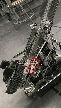

So to get the benefit of all three flap sizes, you should use all three in a staggered configuration. The short flap has the most efficient energy transfer because there is little to no energy loss in the deformation of a short flap. This is because short flaps are more rigid than any other flap. On the other extreme is the long flap. While this flap has a greater margin of error for intaking, it is malleable and energy is lost in the deformation of the flaps. To get the best of both worlds, you stagger the flaps.
This is how I did it on my tower takeover robot. There were virtually no issues with intake compression. I was able to do 11 cubes on 200 rpm motors consistently and quickly.
If you take a close look, you can see the large flap contacts the game object first and is further supported by smaller flaps. The intake flaps were much more resistant to deformations this way.
Another option is to add small pieces of metal attached behind the large flaps like Ethan from 7700R showed in his reveal/explanation vid:
7700r zip tied pieces of 1x bar to the back of their long flaps in TT. Seems to have worked wee for them
Either option works, I think my flap distribution is more practical for most people because it doesn’t require any custom parts. I think the 7700r option probably will work better for cubes. But balls have a tendency to roll when intaking so you do want a bit of compliance from the intake.
