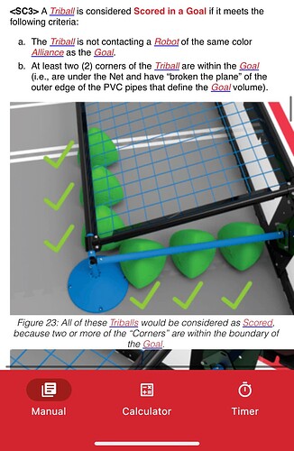

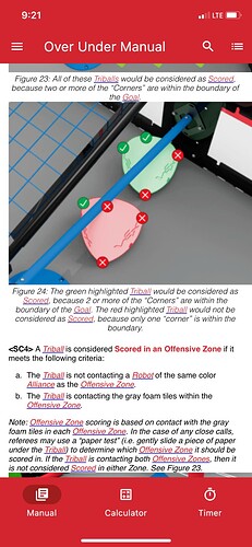

Since the goal a team is meant to score into is in their offensive zone, and while scoring gives 5 points and having a tri-ball in the offensive zone gives 2, does this mean that scoring actually gives 7 (as a tri-ball would both be in the goal and in the zone)
I mean, this is what the manual says about triball scoring…
