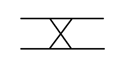

My team has been working on a 3-stage reverse 4 bar lift this year. When we raise it under it’s own power, it goes up without much strain on the motors or any skipping, but has a major tilt to the left every time. We have tried tightening down all of the connections, but it barely helped. We don’t have potentiometers to fix it with software. I will try to post pictures as soon as I can. Any help would be greatly appreciated.

Are you sure all of the motors on the left side are running? Are there any excessive sources of friction on the left side (for example are the screws and nylocks on the left side a LOT tighter than the ones on the right)? If your using rubber bands do you have more on the right than the left?
In general, lifts this tall have a lot of sway, and if one side gets just a little behind the other it can quickly become magnified. You should connect the two sides of your lift on all of the stages at as many points as possible.
As has already been said, check that your connections are fine and any elastics are identical on both sides. Also check your motors: are they all plugged in and working, are they all the same high/low speed, are none of them broken, same power in programming, and also that none are plugged into ports 1 or 10(they give a bit less power than 2-9).
Also, do you have both sides linked together physically? This should help a ton in making it more stable.
A triple reverse four bar lift is inherently prone to tipping to one side and swaying. However, you can minimize this by physically connecting the sides of your lift where possible. I recommend diagonal bracing using narrow bars, as seen in this sketch:
https://vexforum.com/attachment.php?attachmentid=8616&d=1412124353
Do you use 2-hole-wide c-channels for this, or actually 1*25 bars?
You should be able to reach the height you need with a double 4 bar, a triple one seems unnecessary. Leaning and twisting is allowed to occur by almost inevitable slop in the joints of the arms, so if you can reduce the number of stages and joints, you can reduce the amount of slop in the mechanism. This can reduce leaning and twisting of the lift, similar to a 1-stage 4-bar being much sturdier than a 2-stage version.
I use 2-hole-wide c-channels for the main lift bars and 1*25 bars for the bracing.
Hmm, OK thanks. Might have to try that later on. We have 5-wide c-channels going straight across, perpendicular to the lift bars right now.

I would say connect the left and right sides in more places. And, try to connect the vertical rails (the ones with all the bearings) with more than just axles and collars. And, you need to put bearings on the rails that make up your 4 bars.
Also on a side note, (I assume you just built this out of what you had) in the future I would buy more c-channels and less chassis rails.
The 2 motors on the lift at 1:3 does not look like enough power to make your lift work. Most times teams use 4 motors at 1:7 to make RD4B and you have an extra 4 bar on top of that.
In terms of lifting strength 1:3 on a triple 4 bar is the equivalent to 1:1 on a single 4 bar.
It also looks like your lift is all made out of steel which isn’t the end of the world but needs to be built around. The lifts I referred to that have 4 motors 1:7 are designed to be extremely light and use all aluminum.
Also the axles and bearings used for all the joints can cause extra friction which even more factors into how much power is needed to lift. As well as friction they will have a lot more slop than a screw joint.
The design of the 4 bars actually means you lose about half the height on each one because it can’t go below the horizontal. A 6 bar could probably reach higher than the current lift and would use substantially less metal.
The 1X25 metal bars along the top appear to pull the 4 bar away from its natural location which in turn would create even more friction as all the joints are torqued inwards.
It also doesn’t look like you are using full 17.5 inch long pieces of metal for the lift. This would help lift higher without the addition of more towers/ more friction.
Hope all this helps. :D:D
As Griffin mentioned, you are losing about half your potential height since the four bars can’t collapse past horizontal. When you are designing and you see a potential problem, e.g. the bars are offset on a rd4b, you need to make sure it is actually a problem before you build something to fix it.
Analyzing problems is a crucial step in the design process, so ask yourself “is this actually a problem and what are the consequences?” Otherwise, you may end up creating more problems than you are solving by adding weight, loss of height, friction, complexity and instability.
I would strongly suggest scaling back your design. Simple can often be better; it’s all about execution. Start by coming up with some realistic working criteria for your design. How many cubes does it need to carry? How high does it really need to reach? etc… Start off with goals that you know you can accomplish, and with every iteration you will find that you can accomplish more.
