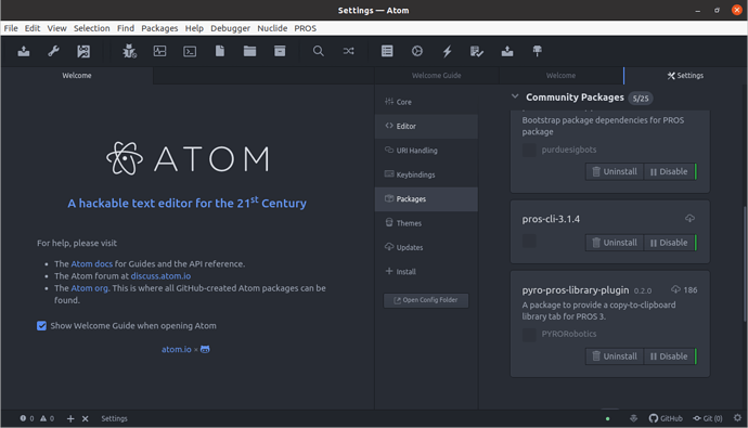

Hello, I am trying to use vex pros on Ubuntu Linux and i installed atom and used the command: apm install [email protected]. I open atom and pros appears to be working but i get an error about the cli not being found even though i know it’s installed.
The procedure you indicated does not install the CLI. Atom is just a text editor, and you installed the PROS extension for Atom that provides convenient toolbar-based access to PROS CLI commands. In fact, you need neither Atom nor the pros-bootstrapper extension to make use of PROS; they are just provided by the PROS team for convenience.
Follow the instructions here to install the CLI. On Bionic (Ubuntu 18.04), start by running sudo apt install python3.7 to install Python 3.7. On Focal (Ubuntu 20.04), use sudo apt install python to install Python 3.8.
Once the CLI is installed, you should be able to run the command prosv5 --version.
Hi, thanks for the reply, I checked my python version and it said i already had version 3.8 but when i entered the command: python3.8 -m pip install --user https://github.com/purduesigbots/pros-cli/releases/download/3.1.4/pros_cli_v5-3.1.4-py3-none-any.whl, From the pros website, I got the response /usr/bin/python3.8: No module named pip. I also looked in my installed packages and the cli appears to be installed see attached screenshot.
I know that for Linux Mint, at least, pip is not installed by default, but you can install it using apt. Try running sudo apt install pip. Then try running the command from the PROS website again

Thanks, I ran the command you posted but I was still getting the cli error. In the end, I just ended up installing it on a windows pc I have.
@pompshuffle I use vscode with pros. I install the CLI using the pip install command found on there GitHub. And you’ll need arm-none-eabi. If you want to give it a crack again let me know. I would recommend Manjaro Linux it’s easier to get the required packages.
