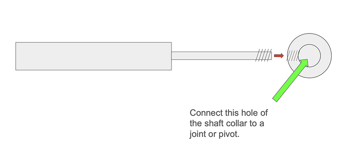

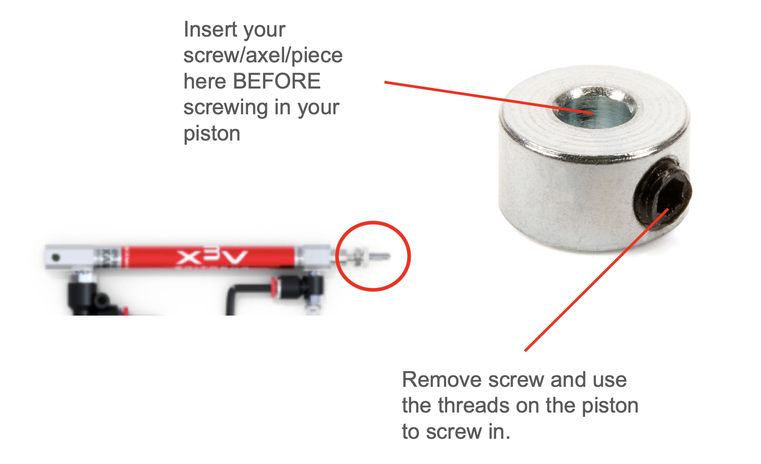

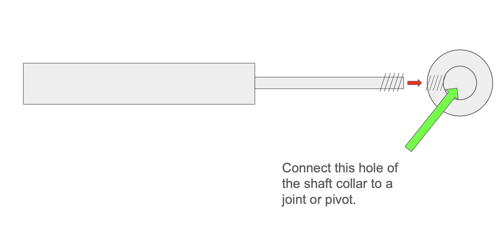

Im not sure if my answer would really help you, but if you are using the new v5 pneumatics kit, you can use shaft collars to connect the end of the piston to. Basically in more detail. you would want to srew in the end of the piston that extends and retracts into the srewthread of the shaft collar. this way you are able to have a perpendicular mounting position to any rotational movement that you want to occur.
does this help? please clarify if not.
This kinda makes sense if you would ellaborate more. I’m newer to vex so I kinda know what you are saying. Thanks
let me know if you need further instruction.
Thanks man this helps a lot. God bless you and good luck for push back this year.
