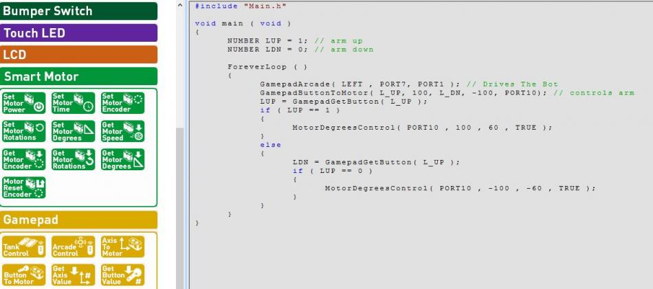

trying to program a hold when lifting arm
my kids are pretty new to programing and they are having trouble with their arm on their bot. the arm won’t stay raised unless they hold the button down on the remote continuously. is possible to add in extra code to tell the bot to keep the arm raised after they let the button go? they are using easyc to program. I don’t know enough about this to help them…

in easyc we have set motor degrees and set motor rotations. will either of those work? does anybody else using easyc know?
Ok. we tried to use the set motor degrees button inside an if then loop. The arm will raise up now and stay but we can’t get it back down.Here is what we have so far. We have no idea what we are doing…

Are you able to use one of the free languages (Modkit or ROBOTC) as most people (me included) can provide better help with these. Or are you comitted to EasyC?
I’ve had a quick look at some tutorial videos for EasyC V5 and I haven’t seen a motor hold equivalent but ot must be there somewhere!
I think we are committed to easyc because I cannot install new software on our laptops here at school, only IT admin people can. I’m pretty sure easyc is the only software the county purchased.
