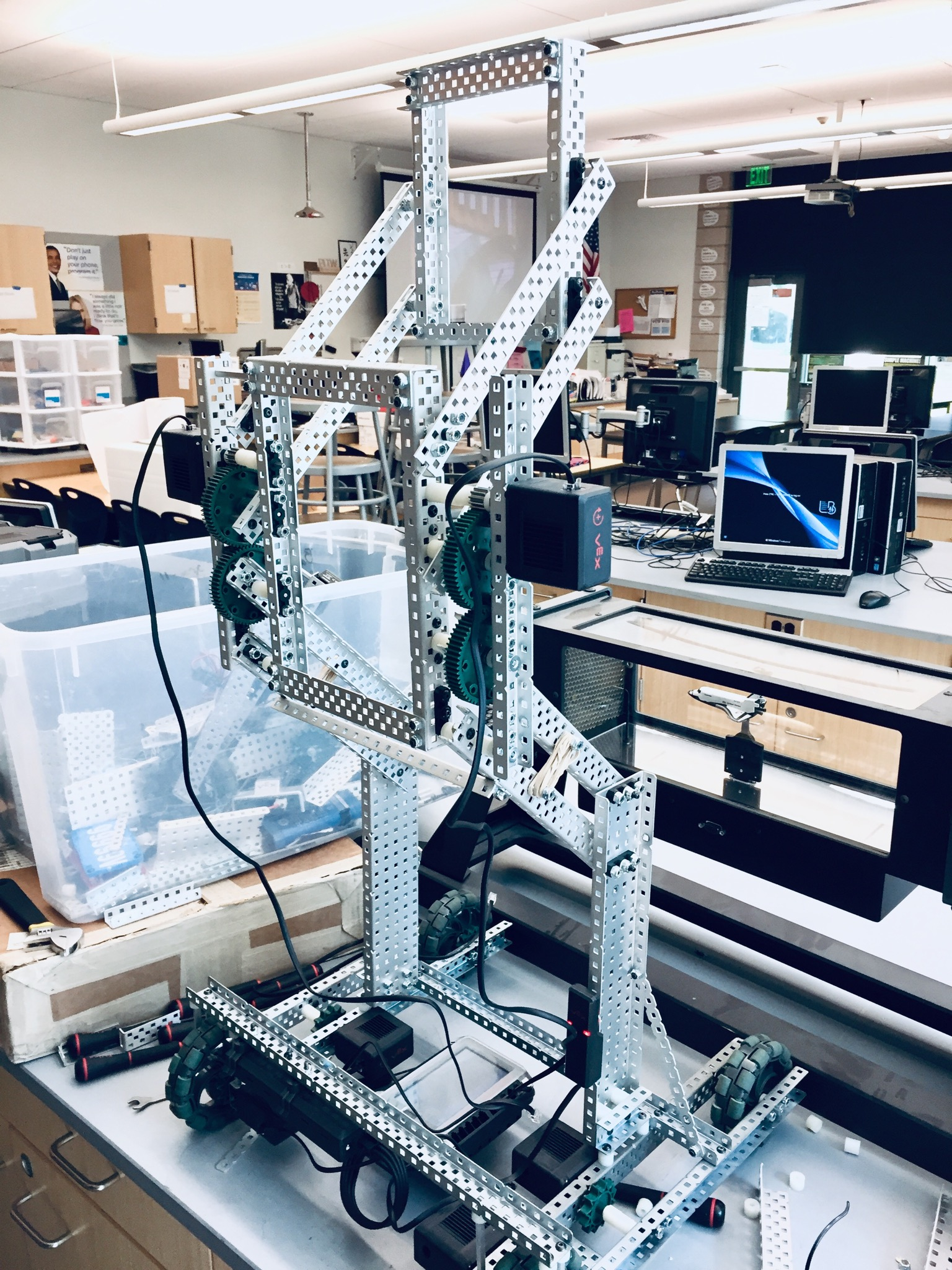

The intake isn’t even on yet, but I just had to share it.
Also, one of the sides looks to be further back than the other, but both sides are the same. Any ideas why?
Edit: it’s a dr4b that will have an intake/storage that expands for maximum stackiness!
some recommendations I have:
  • don’t have your wheels cantilevered on your drive like that. its really bad for friction and your axles will have bending issues. try supporting the shaft on both sides.
  • same deal with the joins on your lift. shaft joints are almost never ok to cantilever. if you switch to screw joints, you’ll be able to cantilever them and have improved performance.
  • your wheels are really close together, which might give you some tipping issues. I find that having your wheels spread out gives you a more stable bot.
  • I’m sure this isn’t final, but your battery mount is a bit concerning. it could easily be damaged by collisions with other robots and obstacles. same goes for the lift motors, the last thing you’d want is for your lift motor to be snapped off during a match.
  • It also doesn’t look like you have any bracing at all on that dr4b. I’d be genuinely surprised if it somehow lifts straight like that. try adding x bracing to the second stage and the midsection.
  • your space efficiency could probably be improved. idk how you’re planning on mounting your intake while keeping it in sizing, so you might have some plans I can’t see, but the entire back half of your robot seems empty, moving your lift back could be beneficial.
but still, this is a decent looking start to a robot, could be competitive once you finish it.
Don’t cantilever your drive base, especially on 1/8 shafts. Any radial or axial load on it may result in the failure of your drive train
Your COM and COG are pretty high, would recommend to lower than to prevent tipping issues.
I would also trying to extend and widen your wheel base as much as possible. just one less way to tip.

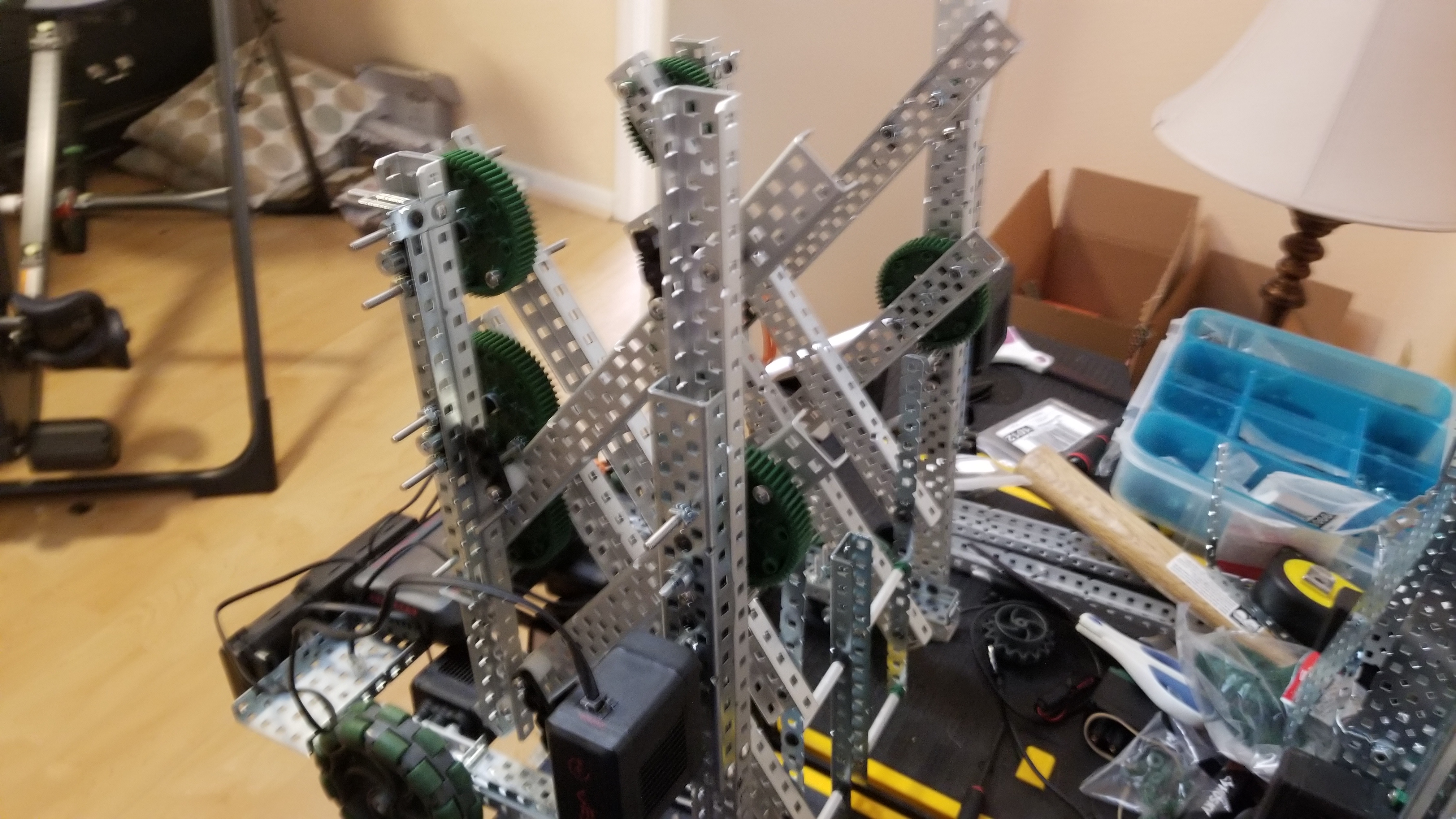

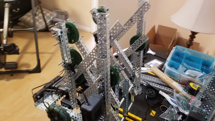

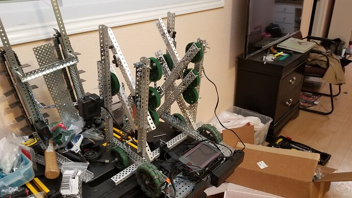

your bot seems very similar to my early design that was later dissembled.
this is a picture of my small dr4b. It too has its flaws but you can probably use it to improve your design.
